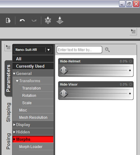

I recently purchased the nano suit from midnight stories but I can't figure out how to remove the head portion of the suit to show the character's face. The sample pictures show the suit without the head portion so it appears possible. Can anyone instruct me on how to do this?

You select the Surface that you wish to NOT see in the Surfaces Tab and set the Opacity to 0%.
The problem with that is the helmet does not have separate material zones. There is a slider under Morphs in the Parameters tab to hide the helmet or the visor (causes both of them to shrink into the Genesis figure's head).
Should have checked that myself, I have the suit. Opps...
That is exactly what I needed to know! Thank you so much :)
