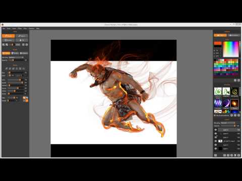

    I would render the character in the clothes, pose, hair. etc that you want and then use Photoshop or FlamePainter (or both) to get the fire effect.
    Here's an example on YouTube where they did it from a stock photo:
