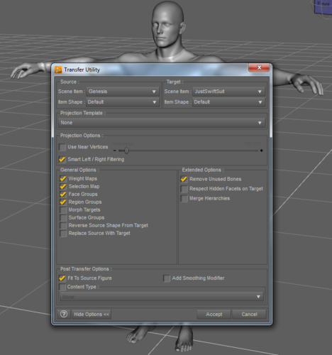

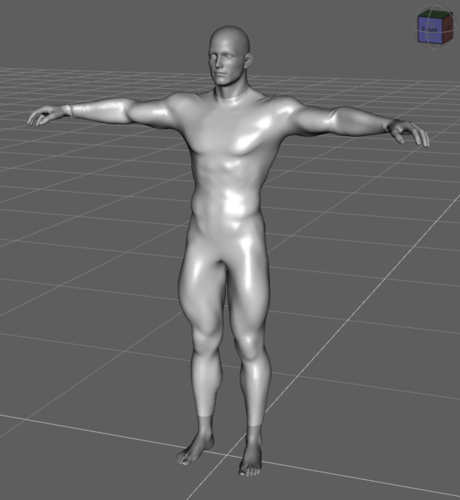

I'm jsut getting started in DAZ Studio, and I have created a bjody suit in another package that I want to fit to my figure. I have imported the OBJ, and it fits exactly how I want it to. So I choose the Transfer Utility and select my Genesis figure as the Source, and my Jumpsuit as the target. I deselect Morph Targets and then Apply. Everything works, but now my jumpsuit has all of the morph targets from the genesis figure applied to it. See images for reference.
Is this the desired behavior? Am I doing something wrong? I watched this tutorial: Transfer Utility Tutorial and followed it, but nothing seems to work.
Any suggestions as to what I might be doing wrong? Thanks for the assistance.
NOTE: The images are in reverse order (it would be great to have a way to change that!)
Bottom: Object is imported and fits perfectly
Middle: Settings for the Tranfer Utility
Top: Result of the Transfer - not good.

    When using the Transfer Utility have Genesis morphed, then click the Source Shape option, select Morph, and then choose your morph from the list - if you used more than one morph choose Current. Now in the additional options check reverse Source Shape from target.
    PERFECT!! That was exsctly what I needed, and it worked like a charm Now I know for the future. Thanks, you guys, for the help. It was a lifesaver!
