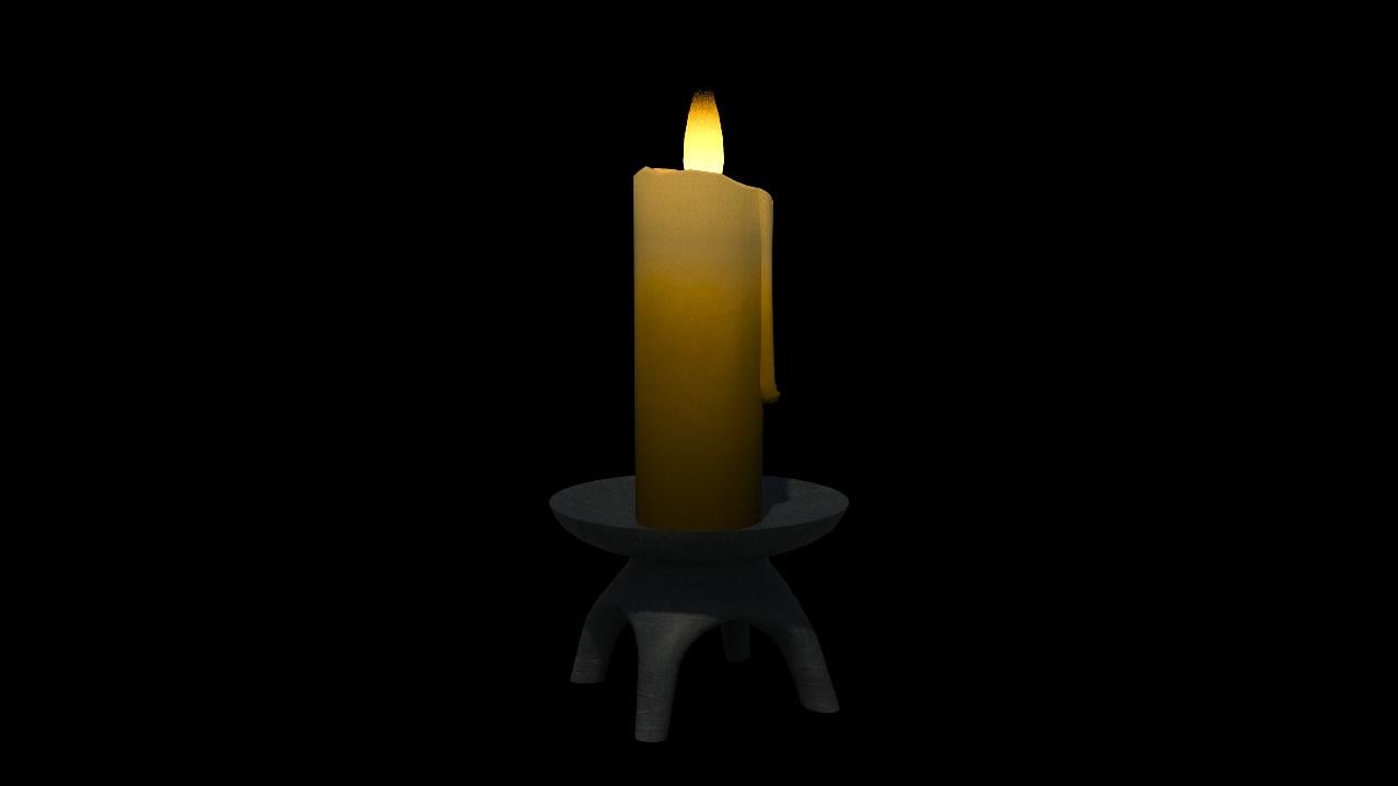

    Here is a quick one using a random candle from my runtime. All it is for the wax is the Uber Base and then the Wax shader on the wax Refraction Index set to 1.44. The flame set to Emissive, Luminance at 0.5 cd/cm^2; Tone Mapping set at 30:4.00:400; Environment Intensity at 0.010 Dome and Scene.
    Click on image for full size.
    1280 x 720 - 63K
