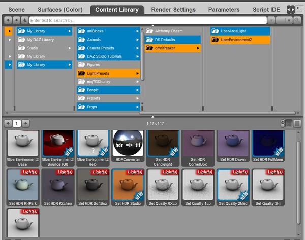

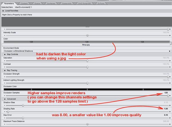

    Image Based Lighting, is a bit as if you painted the
    attached image ( the one with 3 bright spots ) on a giant sphere
    and used this to illuminate the 3d scene
    when rendering in Blender-Cycles you can use such an image as a "world environment"
    Daz Studio 4.5, has bundled with it a "Uber Environment 2" light
    and you can apply an image like that to it ( The image map of the Color parameter of the Light node )
    though usually people use HDR images for that purpose
    to render this image i did this
    - added a uberenviroment2 light to the scene
    - selected the uberenviroment2 node,
    - applied"Set Quality 4 Hi" to increase the quality
    - applied "Set HDR Dawn" to enable Image Based Lighting
    - in the parameters tab of the uberenviroment2 light, i changed the image map ( Color ) to the one i'm posting in this forum
    - in the surfaces tab of the uberenviroment2 sphere material, i changed the images to the one i'm posting in this forum
    - in the parameters tab of the uberenviroment2 sphere i changed the setting "visible in renders" so we can see the "painted" sphere
    - i changed the color of the uberenviroment2 light to gray, because the light was too bright

    Okay thanks, Casual. So this is for Blender or DS4.5 ... and gives that gradiant effect in the background? (Which looks very effective in your office scene, by the way.)
  • mCasualmCasual Posts: 4,604
    edited April 2013
    i added to the post above the instructions about using it with Daz Studio 4.5's built-in "Uber Environment"

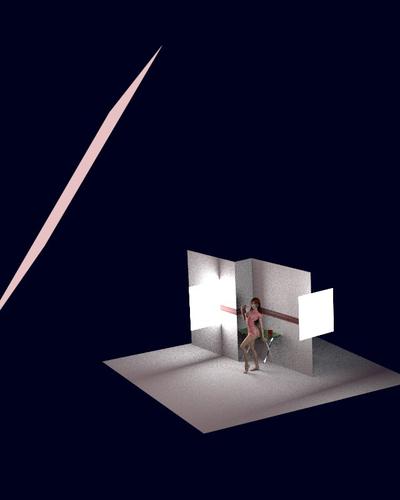

    but in the end i think interesting results happen faster if you
    create 3 lights ( notably Area Lights ) move them, change their size, tint and intensity
    and render ( or real-time preview ) until you get something you like
    in this case in Blender Cycles ( the scene was exported from Daz Studio using my free mcjTeleblender script
    i tried my custom IBL maps but results were boring
    so i created 3 panels with Emissive materials
    and tweaked and tweaked
    [ the pose and scene composition comes from a clothing store
    http://www.mms591.com/www.mms591.com-photo/2011083111/1-110S1112559.jpg ]
    i'm not really aiming at credible realism either
    so it's easier to stay away from the 'uncanny valley'
    the second image shows the 3 area lights and the faint blue world environment
    the large pink panel has an intensity of 1
    the white panel to Amy's right has an intensity of 10 and is quite close
    the one to her left has an intensity of 7
    the world envuronment has an intensity of 0.25
    640 x 800 - 143K
    640 x 800 - 38K
    640 x 800 - 180K

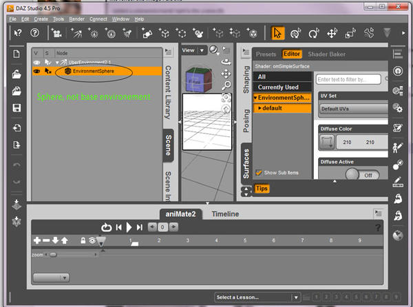

    I just started playing with IBL in DS and found this thread. Using DS 4.5.1.6Pro (64 bit) I don't seem to be getting anything on the Surfaces tab. Screenshot attached showing my surfaces tab after completing the first 5 steps as noted above.
    Parameters and Lights tab are fine.
    Probably missing something obvious - any pointers?
    744 x 708 - 102K
    Post edited by 3dcheapskate on
    it's something that happens very rarely, but
    the image has to be applied to a channel named Color .... in the Parameters tab of the uber...light node
    and it can also be applied to the Environment sphere in the Surfaces tab

    This can be confusing. Uberenvironment has the parent object and the sphere. The settings you are looking for are on the sphere. Note, as casual said.. it can also be found on the Parameters tab, but this made more sense to me for remembering it.

    Thanks Casual/Gedd - so yes I was missing something obvious! Casual's instructions were quite clear (bold red indicates the bit I overlooked)...
    And I didn't even spot that little triangle next to 'UberEnvironment2 1' on the 'Scene' tab in my screenshot indicating that the node can be expanded.

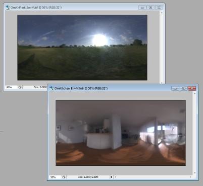

    Hmmm... I'm 99.9% certain that you need to apply an angular (light probe) map in your fifth step, not a latitude/longitude map like the one in your first post. I've done a few checks and the attached image should hopefully make sense and prove the point (I think the angular map needs to be flipped left/right as well, which I forgot to do for the test
    Luckily it's really easy to convert between the two formats using HDRShop Version 1 (version 1 is still free - there's a download link on theHDRLabs tools page here - http://www.hdrlabs.com/tools/links.html ). Converted version of Casual's liteup.jpg from the first post below.
    1024 x 1024 - 32K
    610 x 400 - 75K
    thanks,
    i didn't study DS's environment maps in detail, there's the issue of the sphere UV mapping also to consider
    the equirectangulat map seems appropriate for Blender-cycles ...
    for Blender-Internal-Render's skes and "worlds" i dont know !
    and for DS's UberEnvironment light it's very possible that a probe type of map is needed

    C:\Users\MYUSERNAME\AppData\Roaming\DAZ 3D\Studio3\DAZ Built-in Content\Runtime\textures\omnifreaker\Environment
    there's a .tif and a .hdr for each setting, one must go on the sphere the other on the light-node, and they both look like they are equirectangular
