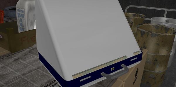

I'm using an old Briefcase freeby from here at Daz. And its always worked before. But in a project I'm using now. When I open the case up.
the briefcase lid is stretching like theres bubble gum inside it.
example pictures closed and open:
The question is What has daz done to screw this up? I can't see any other explanation. It worked in earlier versions of Daz. And is there a way to fix it?
Its been a very useful figure. And I'd hate to loose it.
Thanks.
Dale
2000 x 994 - 154K
2000 x 994 - 211K

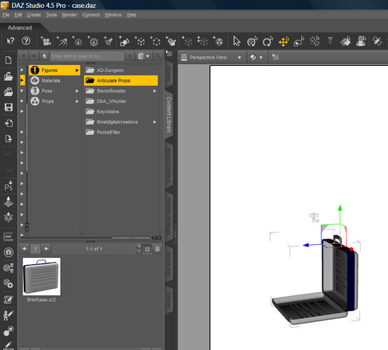

  • BejaymacBejaymac Posts: 2,014
    DS4 doesn't treat Poser figures the same way as DS3 or earlier did, it auto welds the vertices in the mesh to make sure it's a "single skin" mesh, this welding is what's causing your problem, as the vertices of the case body and the case lid are touching and have been welded together, the only remedy is to modify the mesh so there is a gap between the vertices of the body and lid.
    There are a lot of cars out there for Poser that have the same problem in DS4, so sadly it's not something new.
  • SzarkSzark Posts: 10,634
    Have you got DS3 installed?
    I loaded it in to DS3, opened the case and saved it as a scene, then opened the scene in DS4.5.1.56 and the image shows the result. I can also open and close it without the issue.
