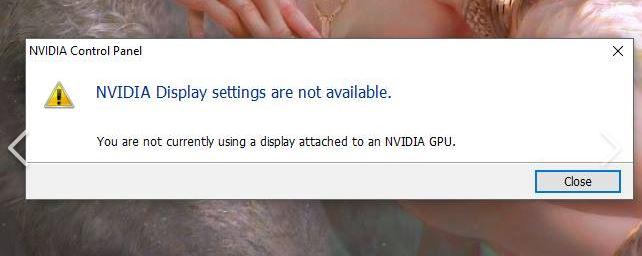

Since yesterday I've been having this problem when I try to render an image with Iray. The whole machine freezes, and the only solution is to force reset.
When I try to open the Nvidia Control panel, I get the following message:
But still, when I'm on DS, and I have the viewport set to Nvidia Iray, it works!
Apparently there's some compatibility issue.
Has anyone had this in the past?
Does anyone know the solution?
Drivers are up to date. Already tried restarting, uninstalling and reinstalling, in different orders, nothing worked.
It is important for me to be able to Render images the proper way so that I can have them in full size.

  • The viewport works but not render to window?  Have you tried rendering to file?  (Can't see the progress but at least we'd know if it was working).
    If Nvidia panel says you're not connected, it sounds like a problem at the card end rather than Daz.  Have you tried taking out the graphics card and putting it back in?   Sometimes things come loose, even if you don't move the machine (it's usually the RAM for me but it could be the GC too).
    What`s rendering to file? I've never heard of it before :O
    I hope it's not the card, it's new. i'll buy a HDMI cable tomorrow. My monitor is connected to the motherboard rather than the GPU. But since it has worked since april like that, i'm trying to find a solution still today...
    How can I take out the card? I need to open my computer right? I don't have the correct tools for that yet :/ maybe i can also buy them tomorrow.

  • PadonePadone Posts: 4,379
    @Taemimun
    You said you have your monitor wired to the mobo AND your viewport set to iray. In my opinion this is generally not a good thing to do.
    If you wire the monitor to the mobo then windows will use the integrated card for the viewport. This has the advantage that the GPU is free for rendering. But as far as I know this way you shouldn't be able to use the GPU for the viewport. So in this case you should use the OpenGL viewport.
    If you want both the viewport and the rendering to be iray then you should wire the monitor to the GPU.

    Bought a HDMI-HDMI cable to connect monitor to GPU. Now when I try to open the NVIDIA control panel it opens and doesn`t give me the Display message in the first post.
    Viewport renders perfectly and FAST. Like it should.
    Normal render: Daz set to only render with GTX 1060 6GB. Renders relatively* well when i first start Daz. After the 3rd render or so, when trying to render, memory usage in task manager goes super high and the computer freezes completely. It`s Daz using all the RAM (8 GB). I didn`t have this before, it used to work perfectly with the RGB cable connected to the Mother Board. And it was so fast! And Daz didn`t consume my RAM like that.
    *relatively because it still freezes for around 3 minutes before deciding it actually wants to render this time.
    So much headache, this is a new computer :( I've even tried old drivers. I'm almost sure that's not the problem.
    I don't know what else to do. crying

    Well, you did resolve the rendering issues by wiring the monitor to the GPU. Memory issues are another story and are quite common. Below something that may help.
    https://www.daz3d.com/scene-optimizer
    I don't get what you mean for "it used to work perfectly with the rgb cable connected to the mobo". What I understood is that you can't render with it. If you have a configuration that works fine then just go back to it. What's the problem then ?
    EDIT: Basically you should have two options now. And in any case the scene optimizer may help.
    1) Wire the monitor to the GPU. This way you can use iray both for the viewport and rendering. But of course it takes more memory since the vram is shared among the windows desktop plus the daz viewport plus the iray rendering.
    2) Wire the monitor to the MOBO. This way you can't use iray for the viewport and you need to use OpenGL instead. But the GPU is free for iray rendering only so you have more free vram.

  • Thank you everyone!
    Problem was solved!
    I talked to a microsoft technician and he uninstalled my last update. At the same time I found out that my mesh resolution was very high. Now i'm not that sure which of he two cases was causing the problem, but it's fixed! *phew* I can finally work on my products again :))
    (There's a way to uninstall updates in Update History > Uninstall Updates) then the technician used a software called wushowhide.diagcab to hide the update :)
