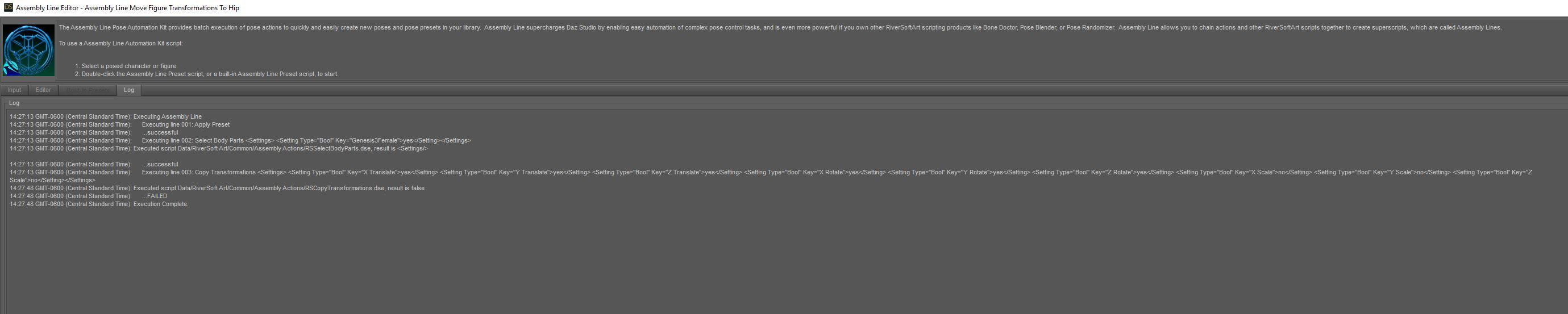

    Here is my log file.
    At start G8F is selected, open script, add the pose preset, run, and i get a dialogue box saying "Need to select Figure or bone".
    Have tried all the combinations I can think of to trick it into working, including selecting hip vs G8F vs G8F & hip. No luck.
    PS.  Not sure why it shows G3F in log.  Probably orig pose was G3F, but is released as G8F and works fine on G8F&M.  Not sure it matters.  But thought would clarify anyway.

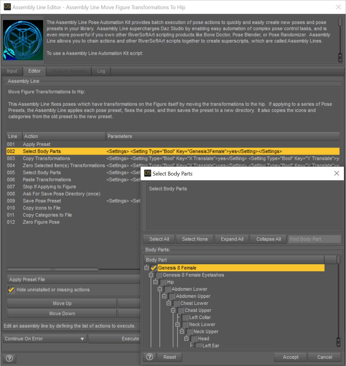

    This assembly line was set up to work for Genesis 3 Female (that is why you see that).  To set it for Genesis 8 Female:
    1. Go to Editor tab
    2. Double click on the "Select Body Parts" line
    3. Check the top-level "Genesis 8 Female" body part only
    4. Click Accept
    5. Now try and run the Assembly Line

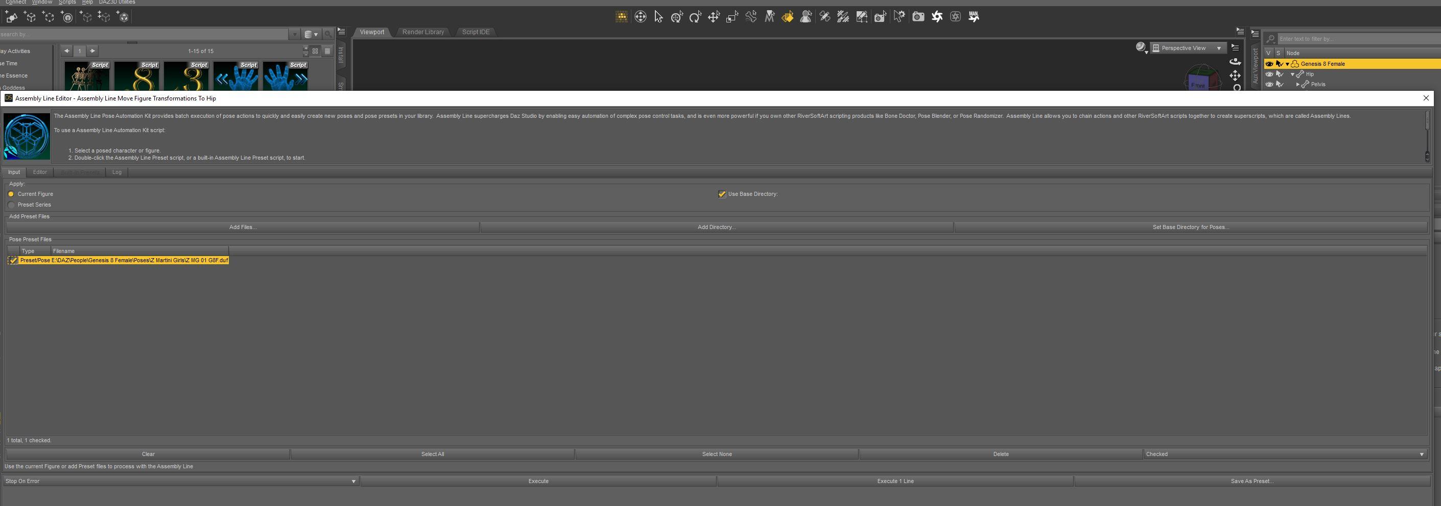

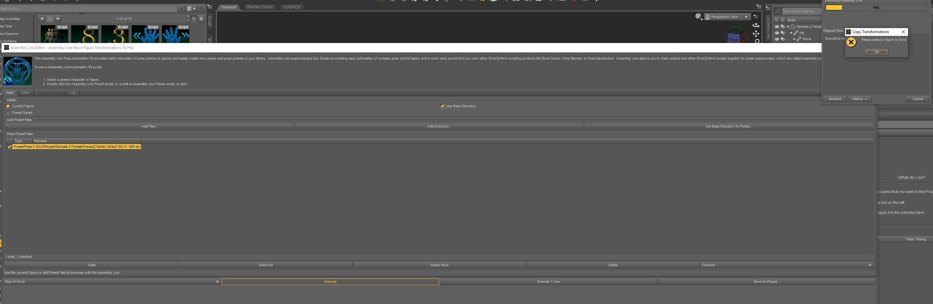

  • shaneseymourstudioshaneseymourstudio Posts: 383
    edited December 2019
    Hey River, I am trying to use the "Move Figure Transformations To Hip" script from this product on G8F base figure. I have the G8F loaded in scene, standard A pose, then I click on the script for it and from that popup box box under "Input" I click on "Add Files" and select the pose preset, auto checks it, then I change the drop down from "Selected" to checked, have tried it both ways, and click on execute, base directory is fine as it to overwrite but also have set a custom directory as well same issue either way, and then I get an error stating that I need to select a figure or a bone. I started by trying to do a whole set of poses from a vendor whose poses all need to be moved to the hip then when I couldn't get it to work I changed to a different vendors' poses to try it on but same issue. I have also tried using the "Assembly Line Editor" script and adding the preset for "Move Figure Transformations To Hip" and still same error. I have also tried selecting the hip instead of G8F main node. I read through the PDF and hovered over tooltips from within ALE but I cannot seem to discover where I am going wrong. I have included screenshots below. Thanks for your time.

  • Hey River, I am trying to use the "Move Figure Transformations To Hip" script from this product on G8F base figure. I have the G8F loaded in scene, standard A pose, then I click on the script for it and from that popup box box under "Input" I click on "Add Files" and select the pose preset, auto checks it, then I change the drop down from "Selected" to checked, have tried it both ways, and click on execute, base directory is fine as it to overwrite but also have set a custom directory as well same issue either way, and then I get an error stating that I need to select a figure or a bone. I started by trying to do a whole set of poses from a vendor whose poses all need to be moved to the hip then when I couldn't get it to work I changed to a different vendors' poses to try it on but same issue. I have also tried using the "Assembly Line Editor" script and adding the preset for "Move Figure Transformations To Hip" and still same error. I have also tried selecting the hip instead of G8F main node. I read through the PDF and hovered over tooltips from within ALE but I cannot seem to discover where I am going wrong. I have included screenshots below. Thanks for your time.
    Input
    Error
    Log
    When the assembly line was written, it was set to select Genesis 3 Female body parts.  To use it for Genesis 8 Female, go to the Editor tab, double click the "Select Body Parts" and then check "Genesis 8 Female":
    1174 x 1243 - 359K
    Hey, thanks so much River!
    No problem! smiley
