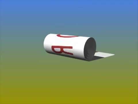

I was using the bend and Twist modifier to roll up a scroll.  I'm getting artifacts whether I use a plane or vertex object - and that occurs even if i smooth the object and turn up modeling and rendering.
Attaching a number of images including a closeup to see if anyone has idea how to fix this.
Wanted to use scrollrolling up one image and unrolling to reveal another in an animation - but artifacts are distracting.  (could mask this area out and just leave an image in its place for the animation, but would like to understand what the problem is.
Please see attached images.
If I just use a solid color I don't get the artifact.

    I look at your images again, it's a problem with the shaders, could you try to check "color only" for this shader and disable the reflection?

  • @DUDU - much thanks for sharing that scene.   I had already removed reflections, transparency and anything else I could think of that might be messing things up.
    Did a bunch of testing - and it looks like you created a morph to tilt the axis of the plane/grid - and that you sync that up with times when the scroll is rolled up.  This has the effect of 'loosening' the scroll and keeping the paper (plane/grid) from intersecting with itself and causing the artifacts I was seeing.
    If I remove your morph, I can generate the same problem I was having in my scenes.
    Going to test that hypopthesis out now and see if I can get this working.
    Greatly appreciate the help.
  • Just went back and added similar morph to my grid and instantly fixed the problem!

  • Only stumbling block now is I really wanted a scroll that was textured on both sides - otherwise looks kind of weird when you see the front showing through as it rolls up.
    Thought I could do that with Fenric's Toward/Away shader on a mixer -  but I'm getting variable results, where the front and back mix together.  Looked up the plugin and has to do with whether or not the normals are pointing at the camera.  In some experiments with just a color on each side, seemed to work part of the time - then other times got that mixing problem where you'd see alternating texture from front and back.
    Just tried making a squashed down cube, very thin, so looks pretty much like a plane or grid.  And after assigning shading domains (top, bottom, and sides) - I applied the same bend modifier, and can put a texture on each side and roll up without any artifacts or bleed through from wrong side.
  • May have spoken a little too soon - still get some issues with rolling and unrolling - but have things working well enough for what i need, so need to leave this for now and do some more experimenting when I have time.
