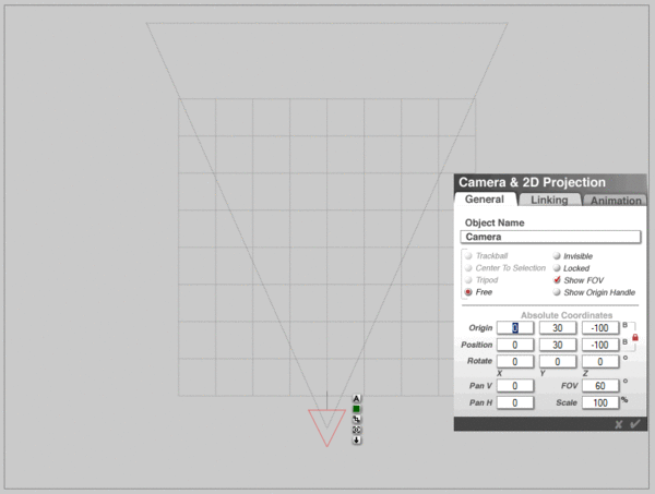

    @vindazi: When you first start Bryce, change your view to top view and you'll see the camera is at the upper left corner of the infinite plane. Think of the infinite plane in terms of the four points of the compass, top being north, bottom being south, right being east, and left being west. On the Sky & Fog Palette you'll see a roller ball on the right side of the palette, which also corresponds to the four points of the compass. Top being north, bottom being south, right being east, and left being west--and all points in between.
    The sun is usually on the south/southeast side of the infinite plane, so you need to move the camera to the south side of the infinite plane to see your object/figure as it's lit by the sun. With the camera on the south side of the infinite plane, it's just a matter of moving the roller ball to set the sun in the position you want.
  • HoroHoro Posts: 11,740
    As GussNemo says. Place the camera to look north. Then all controls make sense: sun position, Starfield, HDRI. Set up a simple scene with everything in the position you want to start a project with, and save it as default.br7 in the folder where Bryce is.

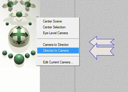

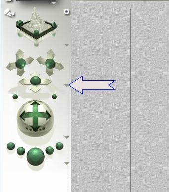

  • David BrinnenDavid Brinnen Posts: 3,136
    From this little arrow - image 1
    You can select from this menu an option to move the camera to the director or the director to the camera, which ever you would rather. In this way you can position the camera where you want it in the wireframe and then send the director to that position with this control. Then you will have the director where the camera is but still have the alternative controls that are associated with that camera.

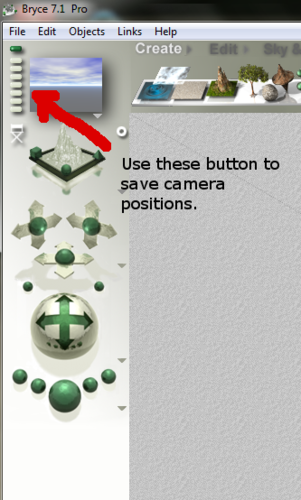

    vindazi, you can also save your camera position(s) by using the small buttons on the left side of the preview pane. This way you can put your camera in the final position but also go to other positions to view the scene.
