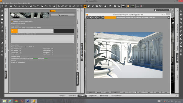

    The texture can be resized to 1/2, 1/3 or 1/4 and will take less space in the VRAM.
    The original texture size is not lost and can be quickly restored by selecting the default size of 1 again.
    I attached a screenshot at the end of this post showing the OcDS texture tab.
