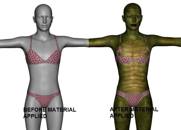

I having an issue trying to find clothing to fit my genesis character when using the Drakon pack. Shaping isn't an issue, that works fine, I'm finding an issue with the material when I apply it to the genesis model. I've included an image of the issue. Can someone give me an idea of what to do?
Is there anything else that might work? Or can I find a solution for doing this?

    There are various things you can do to solve this sort of problem, which we commonly call "poke-through." Probably the first thing I'd try is to adjust the smoothing modifier (select the clothing item and look in the Parameters tab under General>Mesh Smoothing...if you don't see it there, the link below has information on how to apply it).
    Here's some more information on this and other potential solutions: https://helpdaz.zendesk.com/entries/21178872

    I've taken to applying a push modifier and setting it to 0.1 (1mm) and going up from there till it pokes through no more... Edit/Figure/Geometry/Apply Push Modifier/
    You adjust under parameters in General

    There is now reason applying a texture should effect clothing fit in preview. If the texture also has displacement that could cause poke through when rendered. If it is from displacement a push modifier is the easiest fix. You can use trail and error to determine the amount of offset or use the displacement setting to calculate it. Studio displacement is based in centimeters as is the Push modifier's offset.

    Pretty sure the Drakon has displacement, and a lot of it... I'd forgot about that :)
    Yeah. Looks like a displacement issue to me.
    If nothing else works you can turn displacement down or off on the materials of Genesis in the Surfaces tab. Drakon looks like it might need that, though. I usually do that on male body textures where they've used disp for a subtle vein displacement that isn't worth having no clothes fit (and wouldn't show with clothes on anyway).
