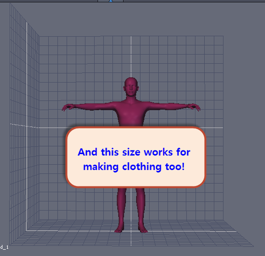

2. In screenshot, you see that I have a small human model, but picture on the grid is very big. I want to resize that I can locate it behind the head of my model? How I can do it? It would be helpful for creating hairstyles.

To get the model to match your ref pic, you can either re-import it at a larger scale - if is a Daz/Poser model, import at 500% and export the hair when it is done at .002% if it is to be made to fit a Daz/Poser model. Otherwise just scale it up - drag on the center yellow block in the universal manipulator.

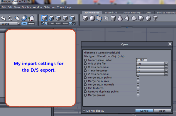

So ... these are my export/import settings to get a figure I can see in Hexagon.
What is showing as a 'custom' export ... is actually a Poser export. It turns to custom when checking/unchecking any of the options beneath.
And the export out from Hexagon would be the same setting as for the import to Hexagon. 1m
Then importing it into D/S at the Poser setting will have it correct.

I'll try this for scaling of model.

I realized how have a small picture without scale of models. :D
Click on Scene Properties > load any reference image.
Then click on Window > New View > you now can resize picture + locate anywhere in Hexagon. :)

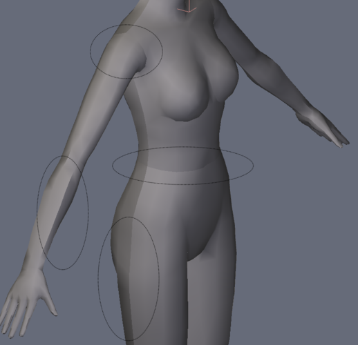

I have a question. I have character from game The Sims 3, but when I import in Hex, seams on the body are visible. How I can set that Hex can import mesh without affecting on the normals?

I do not believe Hexagon alters the normals on imported models unless instructed to do so in the import dialogue. Any problems will have occurred before import. Tell me, is the model in your illustration made up of more than one part?
This model is created by EA developers, i.e. The Sims 3 game.
I just use it due creating of hairstyles. :)
In Milkshape 3D after importing, I don't have visible seams on body. Program normal re-calculate normals.
But, when I import this model in Hex, I get visible seams.
Hm...maybe it's due because I have body in parts (torzo, head, scalp, feets...)?
I would check the .obj export settings in Milkshape and of course there is a possibility that there are not any normals from Sims meshes in Milkshape have you checked ?
I am not certain but maybe something to do with smoothing groups in sims meshes.
And no not because of separate parts, if the mesh was just one part then maybe a problem :)
