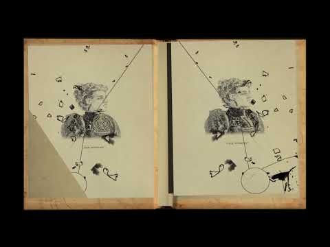

    I have a functiong video but not what I wanted but it gets the message across - I;ll post it when I get it uploaded

    thanks Dudu, when I do that I get a file error right at the end but I can go and get it intact from the Temp folder luckily !
    this is what I am trying for - that hand made look
  • DUDUDUDU Posts: 1,945
    Very special and well done!
