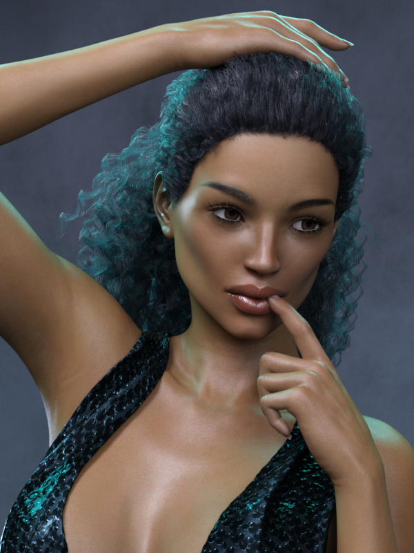

    Settings:  NOV1    Lights 1, 2, 4, 5, 6, 6b
    This figure has a rotation and is NOT directly forward.  She is -41.64 (Y rotation)
    Character Rotation:  Y Rotation  -41.64
    Tone Mapping: Remember to set your Film ISO FIRST, because it changes the Exposure Value slider!
    Film ISO  157
    Exposure Value  12.83
    Burn Highlights  .28
    Crush Blacks   .25
    Presets Used: NONE. Load up the Default, then change individual lights. Remember, spotlights will be in Parameters, the mesh are in Surfaces pane. Here are the Light Numbers and the Lumens. If the light is not listed, it is not used.
    1. 575
    2. 110
    4. 512   Emission Color  0 / 255 / 255
    5. 350   Emission Color 0 / 255 / 255
    6. 10,000
    6b. 50,000

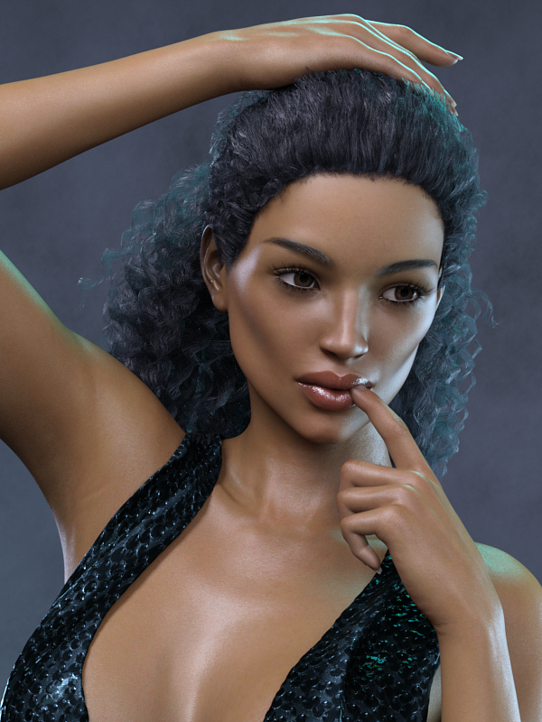

    Settings: NOV2BL     Lights: 1, 2, 3, 4, 6, 6b, 7
    Note: I then saved another preset as NOV2W and changed all the lights that were blue (BL) to white (W)
    Refer back to NOV1.
    What we're doing- adding light to the right cheek (as we look at it) with two lights (3,7), and taking out light from our left  (5) (neck, shoulder, underarm, chest, raised arm) So with this one, the right draws more attention when compared to NOV1. Part of the glow is also removed from the fingers by the chest, and the chest.
    To see the differences, it's fun to open both images and click back and forth.
    Leave everything the same except for the following:
    Turn off Light 5. (That impacts the left side, as you look at it.)
    Turn on Light 3.  In Surfaces for Light 3, select Back (Light Source)   2000     Color: 196 / 245 / 255 (Light blue)
    Light 3 is going to be your right side (as you look at it) and gets the cheek, shoulder, raised finger to the mouth.
    Turn on Light 7.  20,000 (much dimmer than default. This gives the sharp rim on the face and neck, our right, so it's more tame here. It works well with Light 5. ) Color for Light 7 is not quite as vibrant  152 / 200 / 211

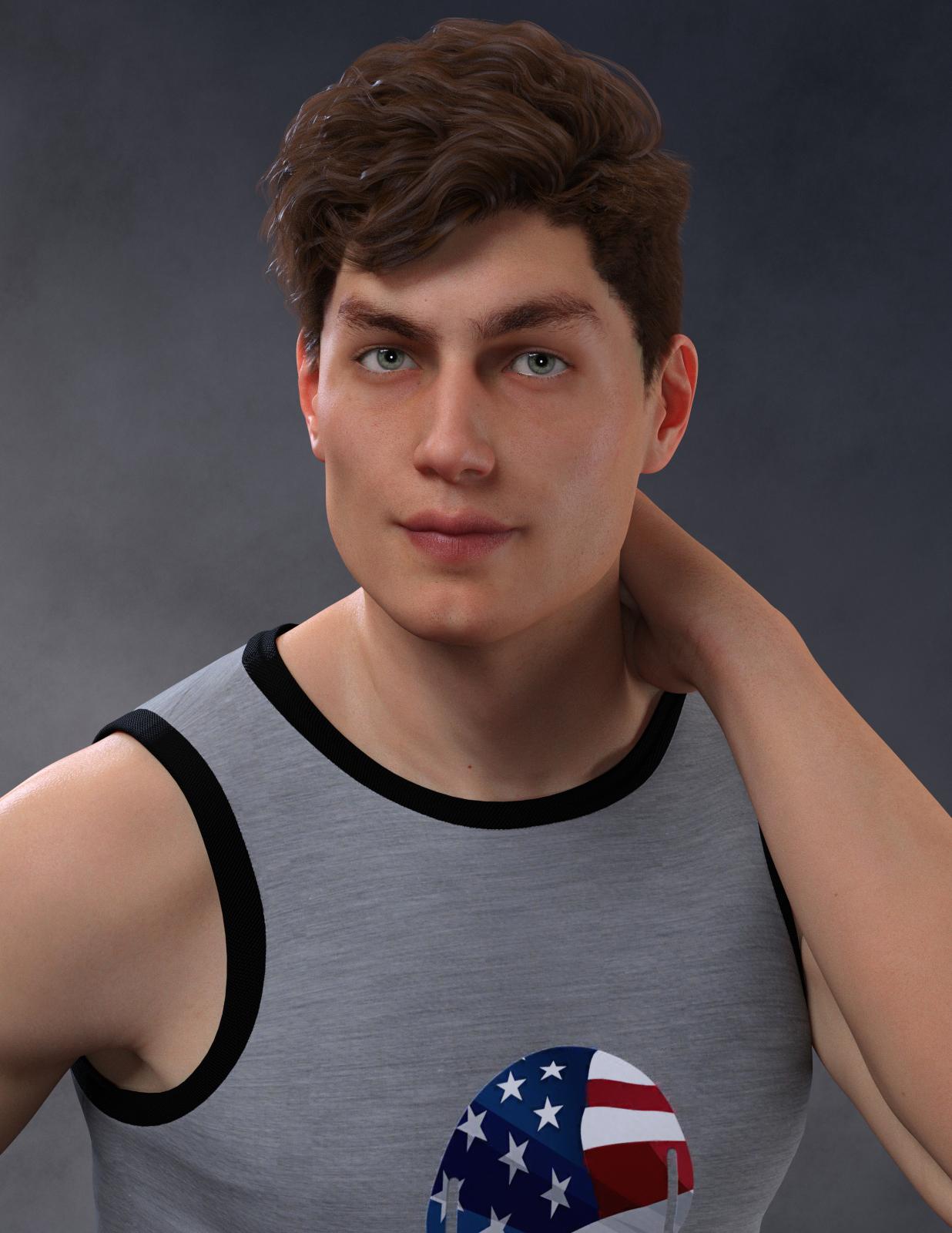

  • luci45luci45 Posts: 2,969
    Hi Novica. I finally got the scripts to work by uninstalling and reinstalling. LOL.
    Here is one just using the soft light preset. Also made a new camera that was in-between dictance. I had to move a couple of lights just a tiny bit so they wouldn't show.
    This is G8M with some M8 and face morphs, Raoul texture.
    1440 x 1800 - 1M

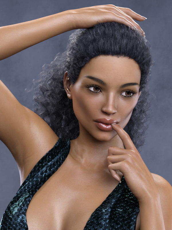

    NOV4
    Again, darken your exposure value (increase the number, to 14.25 or more) for typical caucasian skin. This is using only Light 2 for fill, with the secondary lights of 10, 13, and 14b. Refer back to the post on lights to see what is doing what.
    Light 2: 518
    Light 10: 120,000
    Light 13: 10,000
    Light 14b: 100,000
    600 x 800 - 780K

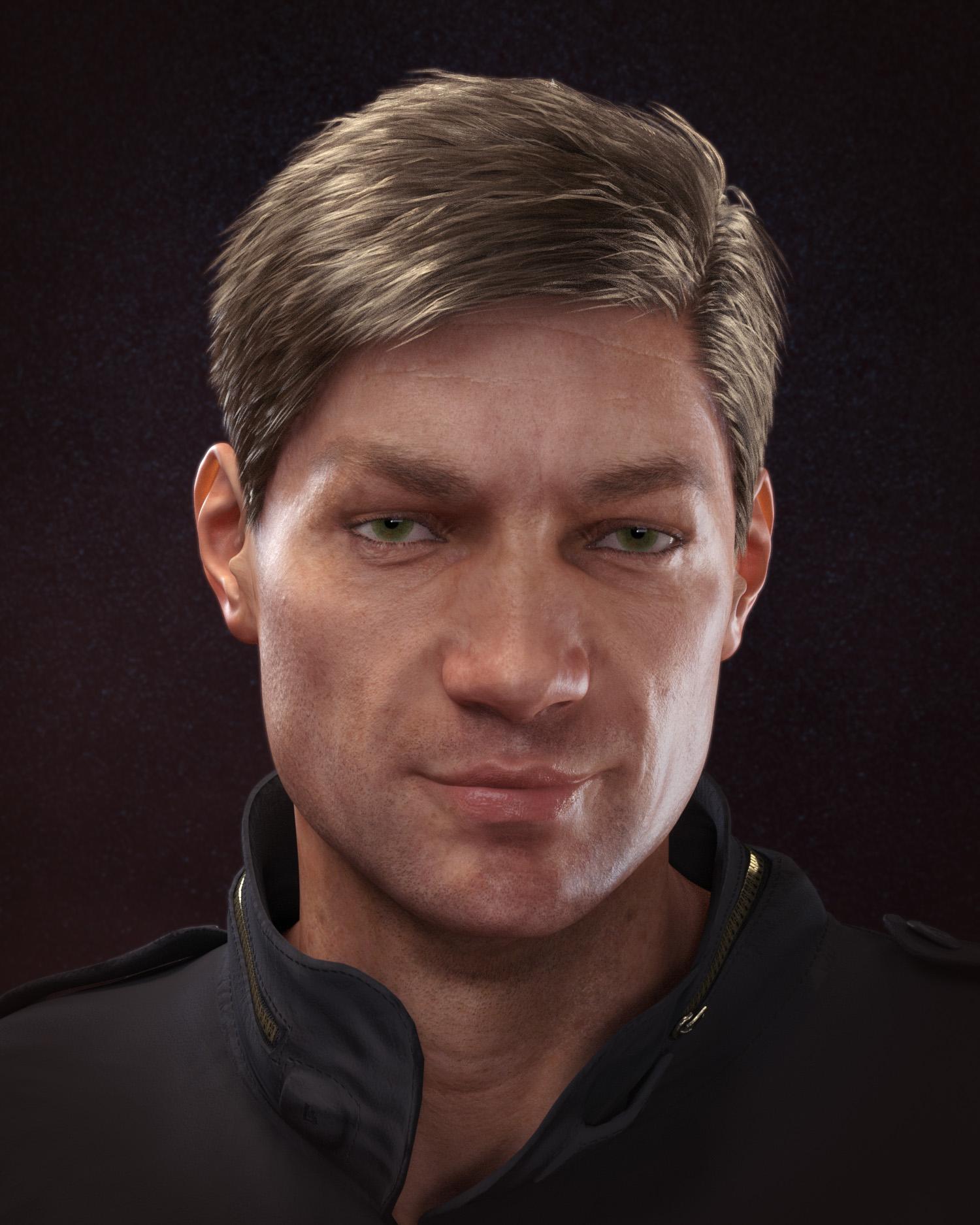

    edited August 2017
    Here are three protraits done with the BOSS lights. I think they were all done with the 1FF CRT setting, but honestly, I wasn't recording the settings when I made the images. I know that in all cases I turned off or significantly reduced the sceondary behind ear light, because it shows white halos and bad effects on hair. I believe I pulled the camera back in all images also. On the woman with pale skin, I reduced all the lights to 90% lumens, using V3Digitimes Iray Light Manger Pro. That tool is indespensible for adjusting a large group of lights like this.
    Drako in HIghlander Outfit
    Michael 8
    Benita for Victoria 8 with Lilith 7 skin
    1236 x 1600 - 1M
    Drako Kilt Mathius Hair Boss Lights 1 Facial Front Complex Right_002 20% brighter higher contrast.jpg
    1600 x 2000 - 2M
    1600 x 2000 - 2M
    Post edited by barbult on

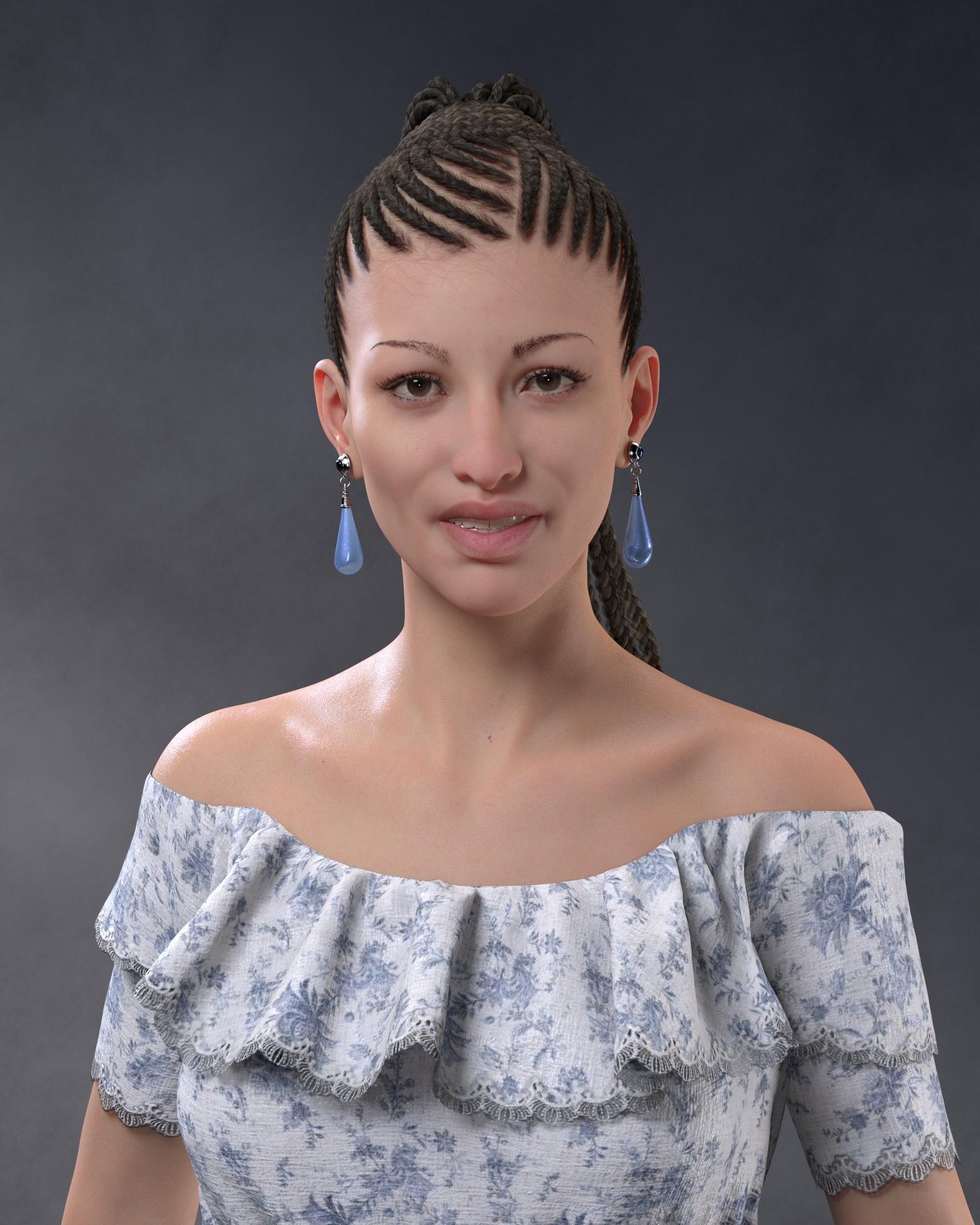

  • dawnbladedawnblade Posts: 1,723
    edited August 2017
    Preset: PLS-4-FL-RT-C Full Length RT Complex
    Camera 7 Full Length Half RT (X:-74.83 Y:155.33 Z:177.73) Rotation(X:-6.09 Y:-24.52)
    Lights: 1,2,4,5,6,7,13,14b,15,17
    Light 2 luminance changed to 600
    Light 6 color changed to light blue rgb 173 216 230
    Light 14b color changed to light orange 244 200 117
    Backdrop Purple Deep
    Mitchell filter 1.00
    FW Galan HD for G3M (Y = 12.51, Y rotate = 13.12)
    I let samples reach 5,000 overnight. Feel free to recommend light changes, etc.
    1000 x 1200 - 904K
    edited September 2017
    After a lot of patient (for me) tweaking of lights, I got something OK with this set. This is Dylan and I think the model is awesome - great skin, eyes, lashes, and morphs!
    These are the things I changed from the default loaded set:
    1-Softbox Rt 500 (Default 750)
    6-Rim Behind RT 128000 (Default OFF)
    8-Softbox 3000 (Default OFF)
    13-Behind Head - I unlocked and moved a little to right to hide it behind him
    14b-back Wall 99000 (Default 222000)
    Background
    Textured backdrop - used Gold Foil and changed colors
    Base Color .041 .016 .016
    Diffuse Overlay Color .24 .14 .14
    metal Flakes Color .12 .30 .40
    Used Face Front Camera - moved it up and back a little
    1500 x 1875 - 528K
    Post edited by luci45 on
    That is awesome, @luci45! Can you share specifics about which light settings you used, what you changed them to etc.?
    Thanks. I will be glad to. I saved the scene and will look it up this afternoon and post here. smiley
    luci45 said:
    That would be great! Thank you @luci45! smileyyes
    dawnblade said:
    luci45 said:
    OK, I edited the original post so the settings are with the render. I didn't change very much even thaough I fiddled with it a lot.
    luci45 said:
    dawnblade said:
    luci45 said:
    Awesome! Thanks for doing that! smiley
    Luci, that's a very nice portrait of Dylan. I like it much better than the promo images.
  • NovicaNovica Posts: 23,925
    @luci45   Thanks for including the settings, he looks amazing!
