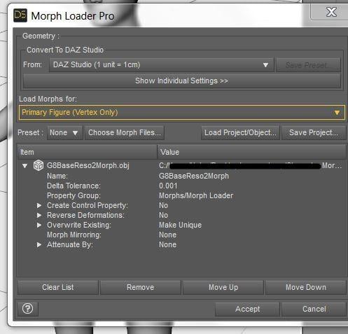

I'm trying to create a morph using Silo. However whenever I try and import the morph with Morph Loader I get the error message:
Warning: Geometry did not match, failed to create morph.
I thought maybe I had added geometry by mistake in Silo, so I tried just importing the .obj, doing nothing to it and exporting it. The same thing is happening. So I'm wondering if it might have something to do with how Silo the obj. is imported- the mesh has a lot of separate parts (see screenshot), but I don't know how to export from DS so it's not like that. Is there something I need to check on the export from DS? Screenshot attached of the default export settings.
Any help would be appreciated:)
494 x 564 - 53K
530 x 629 - 46K

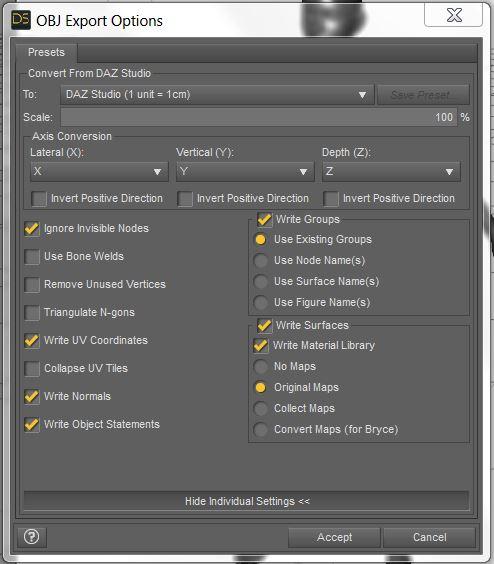

    When you export a figure as an OBJ file for making morphs, you must use Write groups - Use Figure Name (s). If you use some other option (groups, node or surface names) the figure will be exported splited/divided in chunks or parts acording to groups, nodes or surfaces and thus it will have more geometry than original one piece figure so geometry wont match.
    Post edited by ben98120000 on
  • Eva1Eva1 Posts: 1,249
    Hi, the groups were checked as shown in the screenshot.
    I've just tried doing the same in hexagon - exported as base resoution .obj, loaded into hexagon then exported without changing anything and I get the same error message. Maybe I just don't know how to use Morph loader properly yet lol - (although I have followed some tutorials I found). I can't figure out why it's not working:(
  • ben98120000ben98120000 Posts: 469
    edited August 2017
    In screenshot you used Write Groups - Use Existing Groups instead of Write Groups - Use Figure Name(s).

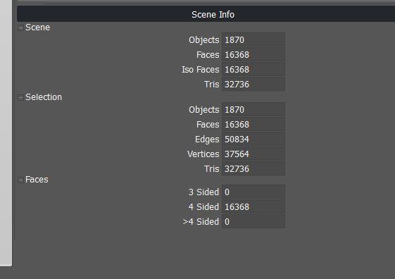

    Eva, if you look at the Scene Info pane before exporting the OBJ, what is the total polygon count (not just for the selected figure)?
    When exporting an .obj for morphing it's "NO groups" ... works fine. I've exported out from D/S and brought them back in to morph. Base resolution and 0 subdivision.
    edited August 2017

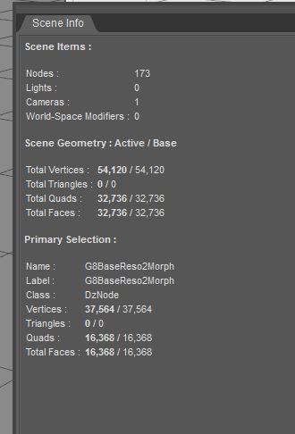

    Hi Richard, I've gone through the process again and taken screenshots of each step (getting kinda confusing lol) with DS and silo (tried the same with hexagon but still no joy) . I bet it's something really simple I;m not doing...:(
    Settings for G8 export from DS:
    G8 info once imported into Silo (I did a small displacement paint after this screensho to act as the morph - the totals remained the same) :
    The morphed G8 imported into DS as an object to see the poly count :
    and then imported instead as a morph for G8 (set to base resolution as before) with morph loader pro settings as follows:
    486 x 491 - 40K
    531 x 591 - 55K
    561 x 396 - 23K
    330 x 486 - 26K
    497 x 477 - 67K
    Post edited by Eva1 on

    Eva1:
    Your DAZ Studio export settings are fine.  People will tell you to change settings, but without explaining how they even affect the OBJ file format.
    Those default "Write Groups" tell the exporter to place a "g" (group) designation in the OBJ file before the facet (faces) code.
    A single "g" before the facet code results in a singular group for the entirety of the mesh.
    The "Use Existing Groups" tells the exporter that you want a multi-group facet mesh based on already established groups within the mesh inside of Studio.
    There are 3 types of groupings that you can see, create, and modify in DS through the Geometry Editor Tab:
    1. Face Groups
    2. Surfaces
    3. Regions
    It is the Face Groups that are written to file in the facet section designating a group (g) per face assignments from Studio with that default selection.
    This is good for morph target work, but you need to know how both programs import/export modules work to be on same page with a successful morph.
    Why the diatribe above?  Glad you asked...
    It's because you haven't done anything wrong on the DAZ Studio side, but you were incorrect with your asssesment that Silo does not have import functions.
    * By default, Silo's OBJ import settings has "Import Groups As Objects" selected, which is why you see all of your facet groups turned into each individual meshes and your vertex count more than doubled.  This already broke compatability for a morph target.
    Which by the way, is one of two things for morph target work that matter (besides keeping one grouped mesh).  Faces and edges do not matter.  Only vertices, both in count, and order is viable for a correct MT.  You can literally strip everything out of the OBJ file except for the correct ordered "v" (vertex) code, and you have a proper MT point cloud.  But, I digest...
    * Also by default, Silo's OBJ export settings has "Export Objects As Groups" selected, which reverses the process and turns each individual mesh back to a facet group desingation in the OBJ file.  Alas, it is already to late, because once those groups were separated, all was lost...
    So, what you need to do is; Under "File" drop-down selections, select "File Format Settings".  When you have that tab you will have another drop-down box containing file formats.  Select "Obj Options", and procede to unselect both the "Import Groups As Objects", and the "Export Objects As Groups" parameters.
    This should solve your "Warning: Geometry did not match, failed to create morph." issue with MLP in Studio.
    Please, give it a try, and be happy...
    * EDIT:  patience55 is correct in that deselecting "Write Groups" would circumvent Silo's Import function, but they are still needed in other software for MT work.
    Post edited by DaremoK3 on
