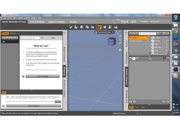

  • wayne06ohwayne06oh Posts: 6
    I transferred the content into the following directory,
    960 x 720 - 45K
    but i still cannot access my smart content, shaping tools... as such
    960 x 720 - 66K
    You need to go to Edit > Preferences > Content Library > Content Directory Manager, and make sure that the My Library folder is listed as BOTH a DAZ Studio Formats AND a Poser Formats folder. It is important that the My Library folder is listed as both DS and Poser.
    It all looks correct to me for the moment, if you do the above to let DS know where the content is, it should work. I see that you also have a 'My DAZ 3D Library' listed as well, that is the default location that the DIM installs into. Do you have content in there as well?
  • Scott LivingstonScott Livingston Posts: 4,352
    To access the Shaping tools:
    (assuming that what you are looking for are the morph sliders)
    1. Select Genesis or the figure of your choice
    2. Go to the Shaping tab and click the Editor button near the top of the pane. (In your screenshot, "Presets" is selected instead)
  • MelanieLMelanieL Posts: 7,867
    I presume you loaded the MetaData by going into Content Database Maintenance (off the Content Library tab, little arrow icon at the top left) and selecting "Re-import Metadata..." ? This doesn't get done automatically if you manually install the content. It's the Metadata that causes things to be shown in Smart Content.
  • jestmartjestmart Posts: 4,449
    You are in the Poser Native Format section of the Content Library. The DAZ Studio Native Format section has a little 'S' on the folder icon.
