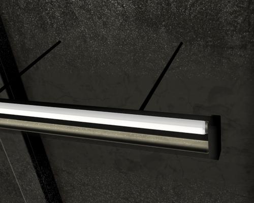

    That works, but make sure that if there is a cover, that it does not cast shadows or the light won't go out into the room.

  • MarcCCTxMarcCCTx Posts: 947
    That one was the tube arond the light, it's a dilapidated room and only one of the bulbs works. If I had applied the light to the glass material, both would have lit.

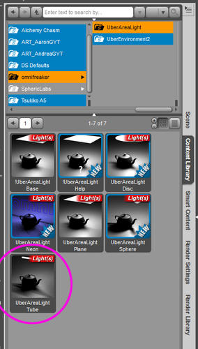

    I'm using the Uber Area Lights which came with DAZ Studio, (might be in the Genesis Starter Essentials!) It is in the light presets oof the DAZ Studio formats. You see that one of the presets is a tube. Which you can resize and move as you need. If this is the only light in your scene, there is something called a light blocker, don't erase that!
    In my picture, I'm using West Park Ward and the light has one of those plastic diffusers on it. I set the opacity (in the shaders) to 20-30% so the light could shine through.

    Ok, in my lights I have a "light tube" and an "area light tube" - what's the difference? Both are .DUF files and both have the red tag "light(s)" on them
    They seem to be the same thing. I have never used the one in the prop folder (labeled light tube), but I just placed it and in the scene tab it's called an Area Light as well.
