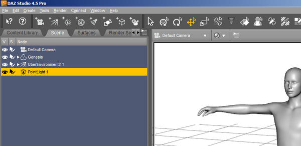

I'm loading up some lights to work with.
1. I add my UE2 base
2. Next I add a point light and my UE2 Disappears from the scene.
3. I try to add my UE2 back and my point light disappears.
4. This could go on forever!

    I an using 4.5.1.56 as well, and it works as expected for me. Maybe a reinstall would help, it doesn't take that long to do?
    808 x 392 - 122K
  • Richard HaseltineRichard Haseltine Posts: 111,760
    How are you adding - from the Create menu or button or from a preset? By default light presets delete existing lights - as light sets in Poser do - but if you hold down ctrl(Win)/cmd(Mac) while loading you can override that.

    I think that is what is throwing me around.
    Thank you so much, Richard.
    That worked perfectly.
    I was loading from presets, but yikes I've been doing this a long time and this is the first time I have run into that ... that I can remember. :/
