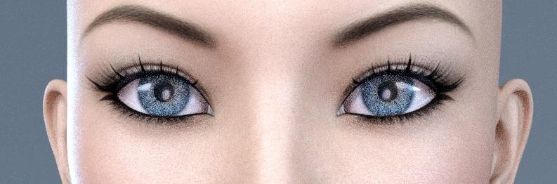

    I don't think this is a vendor issue.  Natsuko's eyes are set up with refraction on the cornea, which makes them a little harder to light.  I don't have the other characters mentioned, so I don't know how their eye materials are set up to compare.  When I apply Natsuko's light blue eye color, her eyes render blue for me with no material tweaks or changes to the settings.  Could it be the lighting you're using?  This image is using one of Elianeck's light sets and an HDRI from an FWSA pack (keep in mind the noise is because I didn't let this render long... just long enough to develop the eye color).
    Natsuko Skin and Light Blue Eye MAT

    Yes,
    Refraction exactly is the problem. There is still a major bug in the interface between DAZ and iRay since the beginning. If light enters below a certain still steep angle, the refractive medium suddenly turns dark.
    But since DAZ claims it a pure iray problem, there isn't any support.
    So you have the choice:
    • realistic (with refraction) but dark eyes,
    • non-realistic (no refraction) but bright eyes.
    This bug affects a lot of vendors and their products. Some I know stated that they had to implement non-realistic workarounds in their (water containing) products.
