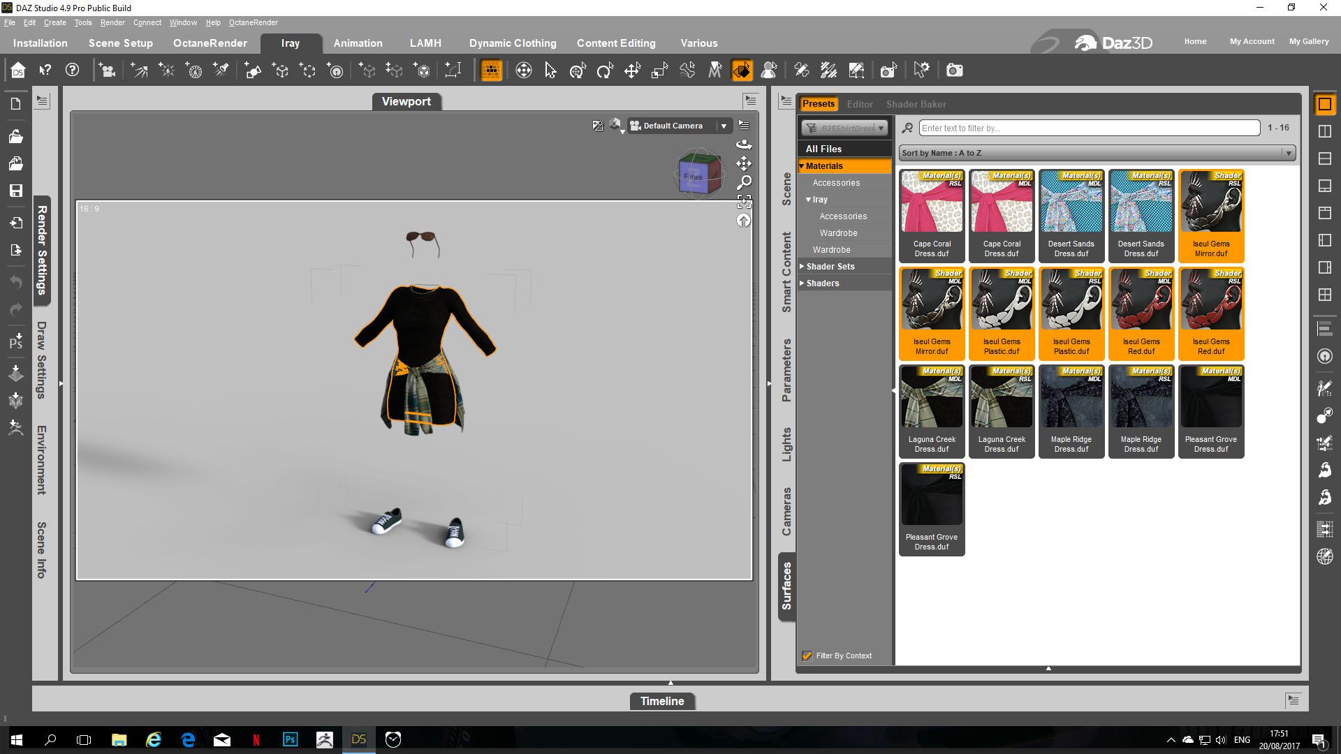

This is how the materials category looks like in the surfaces tab when everything is working as intended.
When taking this screenshot I had 841 products installed. Products with faulty metadata were not installed.

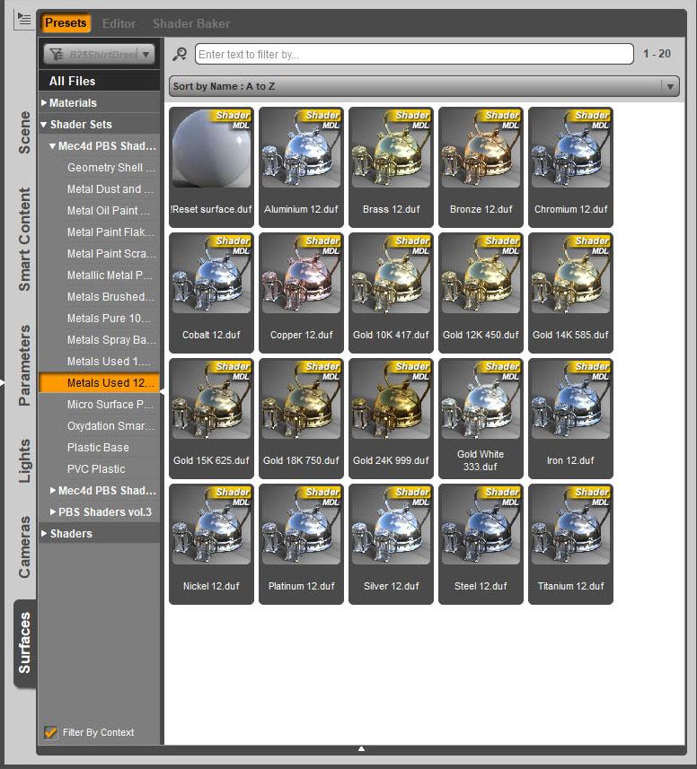

Shaders
Shaders are designed to be applied to any object.
Shaders do not include object specific UVs.
Shaders may use tileable textures that repeat itself without triggering visible seams.
Default shaders are often provided by DAZ3D for the most frequently used official categories: Metals, Glass, Liquids, Ground etc.
The compatibility base of shaders is /anysurface
Because of that shaders show up no matter which surface you select.
Shader Sets
Shader sets are created by specific artists that follow a different category system.

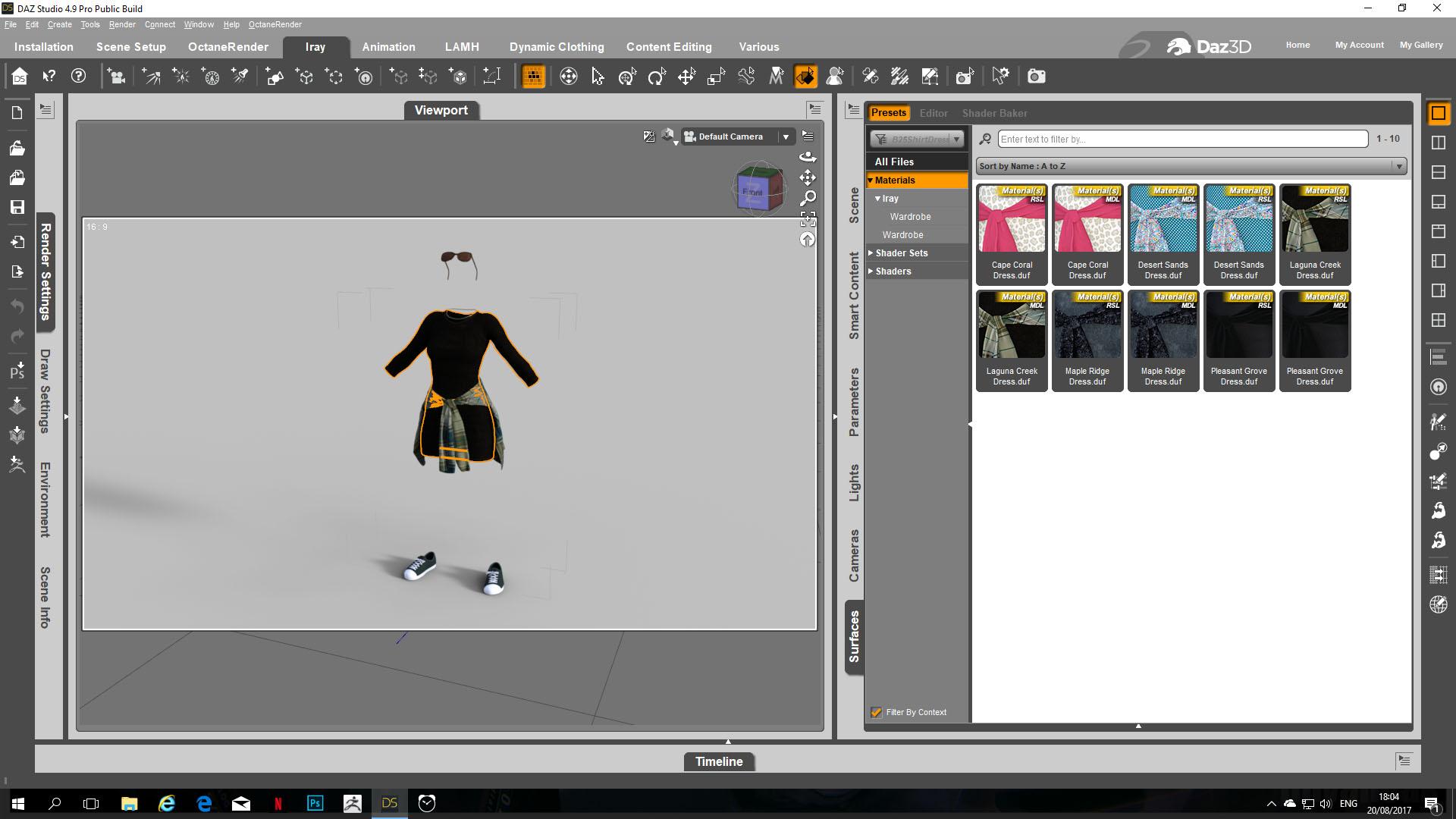

Before:
When you just selected the materials main category only materials of the product selected in the scene were displayed.
Only categories of the product selected in the scene were displayed: Wardrobe.
After:

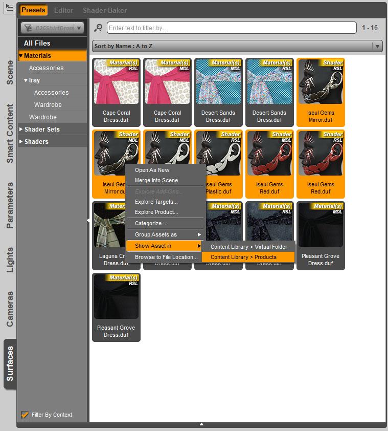

There are six additional shader files displayed of another product.
Instead of just the Wardrobe category now also the Accessories category is displayed

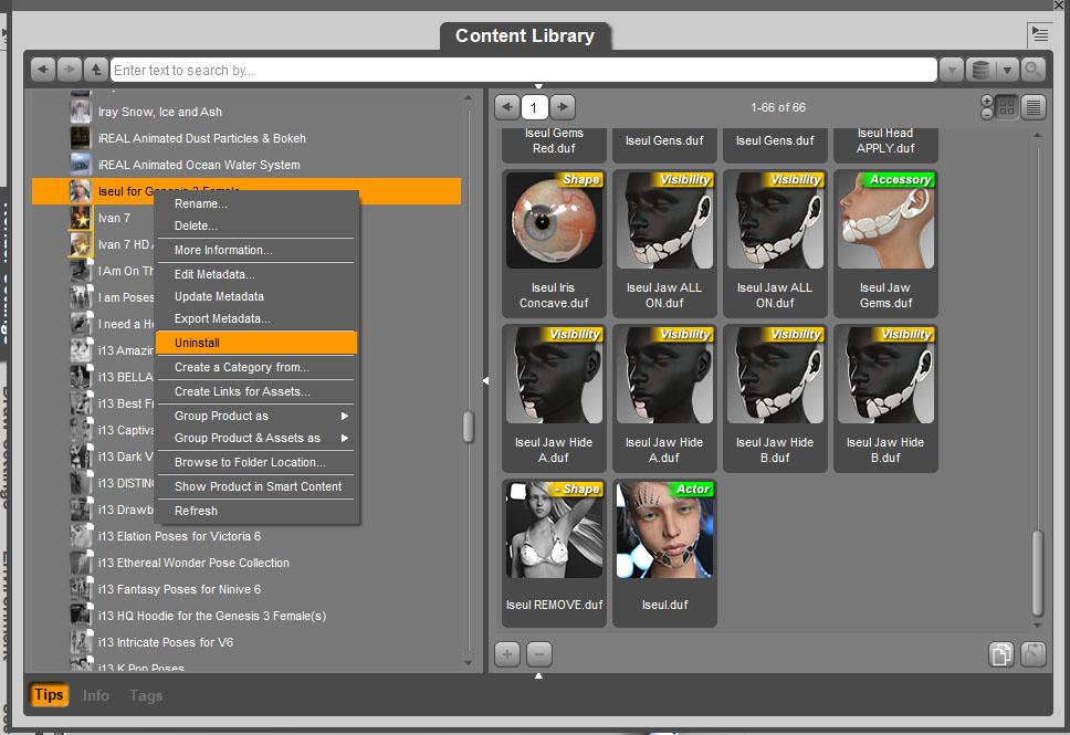

To uninstall the products with flawed metadata
- right click on a shader preset in the material category
- choose show asset in the Content Library - Products
- right click to select the product
- choose uninstall

    FAQ 2) When I have found shader presets categorized as materials how can I check their settings in the Content DB Editor?
    Step 1) In the surfaces tab right click on the shader preset in the Materials category.
    Select "Show Assets in" - "Content Library > Products"
    Step 2) In the Content Library with the misscategorized preset selected open the Menu and select Content DB Editor
    Step 3) In the Content DB Editor check the Compatibility
    In this example the compatibility is /anysurface.
    Based on that we can assume that the intention for this preset was to be a shader preset.
    Step 4) In the Content DB Editor check the Categories
    In this example you can see that the path of the preset "Shade Lighten" leads to materials instead of shaders.
    Note that a similar shader preset called "Shade Darken" was properly categorized as shader.
    A quick look at the Content DB editor can provide information how other materials and shader presets of the same product were categorized.
    Btw: These screenshots were taken on a test latop linked to a 4k display.
    Because of that the interface did not scale properly...
    3840 x 2160 - 1M
    3840 x 2160 - 1M
    3840 x 2160 - 1M
    08 Content DB Editor - Shade Lighten Categories - Material instead of Shader.jpg
    3840 x 2160 - 1M
    3840 x 2160 - 1M
    3840 x 2160 - 1M
    03 Laptop - AFTER Shade Lighten MDL shows up in Materials Iray Wardrobe .jpg
    3840 x 2160 - 1M
    3840 x 2160 - 999K
    Post edited by linvanchene on
