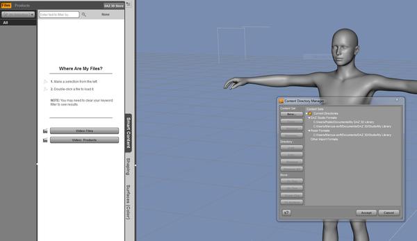

    I'm straight on that part, however I still do not know what happened to my smart content. As I stated when I installed Daz 4.5 pro and the Essentials I had smart content. I then used the DIM and installed some of my purchased products, still good, had smart content. I then loaded up another batch of products and suddenly no more smart content. I uninstalled Daz and then re-installed it but I guess because I did not also uninstalled all the installed product contents, The same issue is still there NO SMART CONTENTS. Here's a screen shot.
    1550 x 897 - 167K
  • fixmypcmikefixmypcmike Posts: 19,719
    It sounds like your CMS has crashed. My understanding is that this can happen a lot on Macs because every time you go to a content folder it needs to mark the contents as seen, and on Macs that sometimes crashes Valentina. You'll need to restart the CMS, then you should "Mark All Content As Seen" after adding each batch of content to keep this from happening.

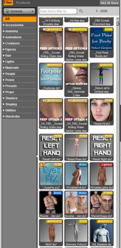

    I had to get down right GEEKY with it; and finally I got my Smart Content back:-). I went to the Knowledge base on problems with the Smart Content. I tried EVERYTHING! suggested, but nothing would work. The CMS was running, but not correctly. I finally had to try the last resort suggested and trashed the CMS & Daz 4.5, and did a complete re-install. I then re-installed both files of the Genesis Starter Essentials, re-imported the Metadata & marked all content as seen, and presto! all of the Smart Content re-appeared.
    I did not re-install Daz 4 since I've been told that I do not need it.
    So thanks to everyone for their suggestions.
