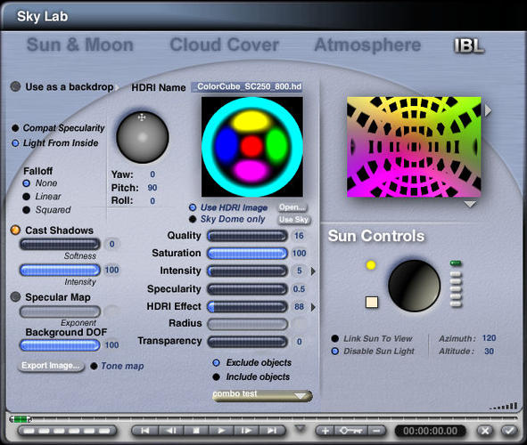

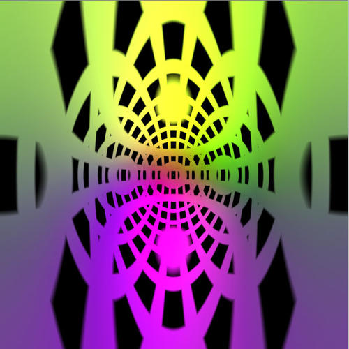

Picture 1 is an example of a pattern cast on the inside of a sphere. It is rendered as panorama.

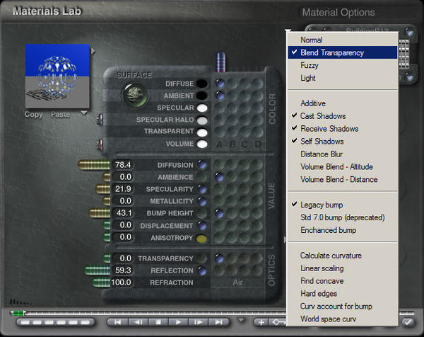

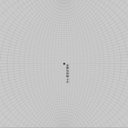

Picture 2 shows the setup. A large sphere with the camera inside it, and a small sphere in the centre (around the invisible HDRI).
Picture 3 shows the material on the small sphere. The important part is to set it to Blend Transparency and set the dot into Transparency. Use Object mapping.
Picture 4 shows the IBL tab with the HDRI used.
