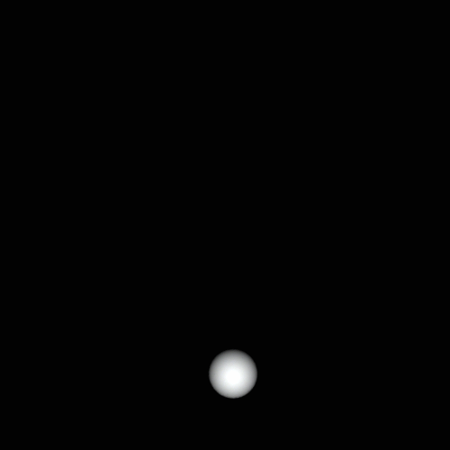

Just discovered something when trying to render an Animation using the new Luxus plugin.
If "Write Resume Flm" is set to ON, you will most likely get a motion blur like mess in many of your frames.
This is ON by default. If you set it to OFF, your animation should render properly.
Also, it helps to set a time limit rendering per frame (halt at time) or a halt at samples per pixel, otherwise it could run forever and not finish.
Attached is a quick example of what happens if "Write Resume Flm" is ON versus OFF.
-Paul
Edit: Another thing to keep in mind is the Write Image and Write FLM Intervals should be less than the halt times, otherwise you will end up with an animation full of duplicates of the first frame.
500 x 500 - 1M
500 x 500 - 2M
Post edited by pwyskowski_9185b57353 on
