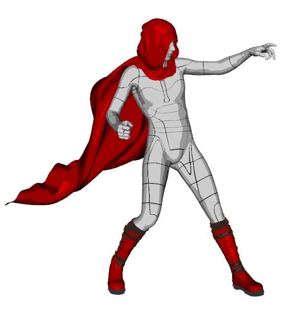

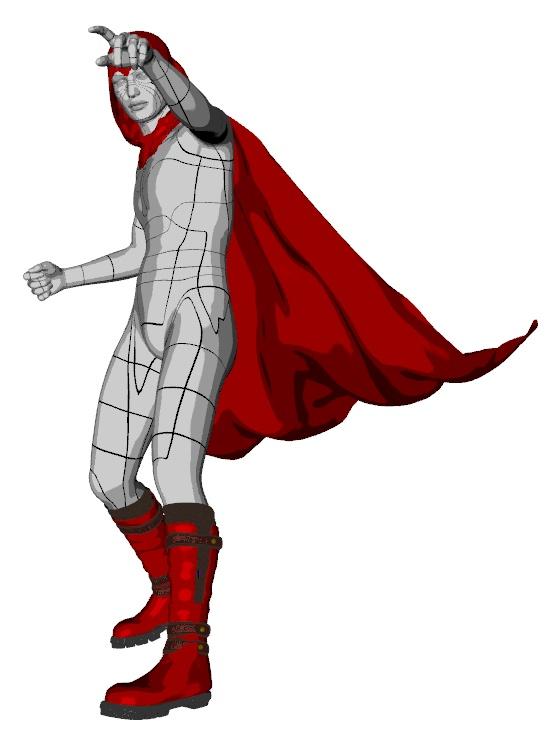

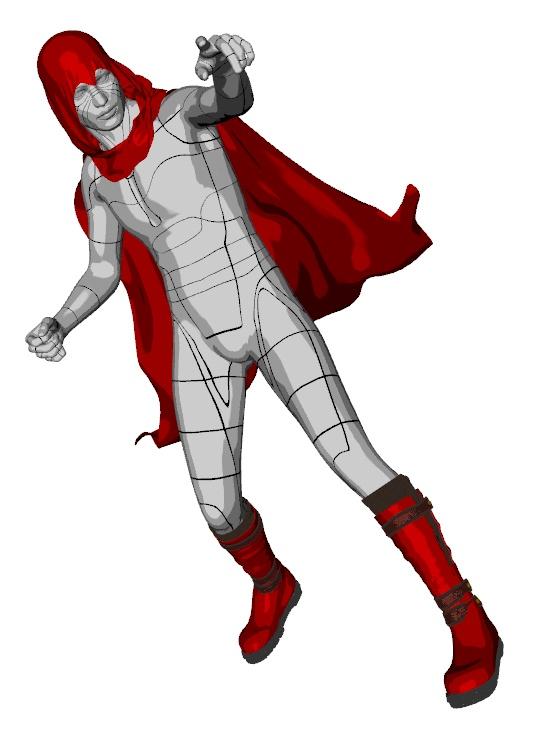

    Here is an example using VWD for dynamically sculpting the hood and cape beyond the initial animated drape.
    550 x 730 - 70K
    550 x 750 - 61K
    575 x 650 - 56K
    550 x 750 - 50K
    Post edited by DaremoK3 on

    The dynamics are great, and I like your NPR style. Nicely done.
    --ms
  • DaremoK3DaremoK3 Posts: 798
    Thank you, mindsong.
    But, I can't take credit for the NPR style.  That is all DAZ Studio 4.9 default Cartoon Preview.  Just screen-shots...
    It's one of the things I love about DS.
