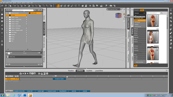

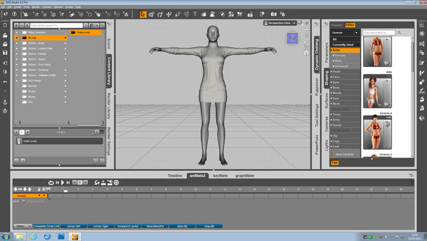

I fitted the 3DAge Small Lovely dress to the Genesis V4 shape using "Fit To"
It gives a very nice result, except that when walking, there are ugly creases at the front of the dress
I'm sure this must be an old problem by now, but unfortunately I haven't been able to find a tutorial or fix for this particular problem.

  • almahiedraalmahiedra Posts: 1,374
    edited March 2013
    SRMS http://www.daz3d.com/sickle-rigging-and-morphing-system.
    With SRMS dress templates. This add a pair of controls, moving it improve hip. Breast problem can be solved with soft tool in Hexagon.

  • wancowwancow Posts: 2,708
    The single best thing you do that is insanely cheap is get the MFD for Genesis and fit your dresses to that.

    In the help file, under Converting Generation 4 Items To Genesis with Transfer Utility, it states "Some distortion will still probably occur, but it can be decreased by increasing the number of smoothing samples in the Smoothing Modifier (and sometimes in the Collision option as well)"
    I can't find how to access the Smoother Modifier or Collision option to change their settings (In the Transfer Utility there is only an option to tick the box for the Smoothing Modifier, and no sign of the Collision option - I know it can be done, but I can't see how)
    Thanks
    EDIT - Solved
    Using Sickle, I got a very nice result, which is great for posing because it smooths the dress into place at the end of a pose ... cool.
