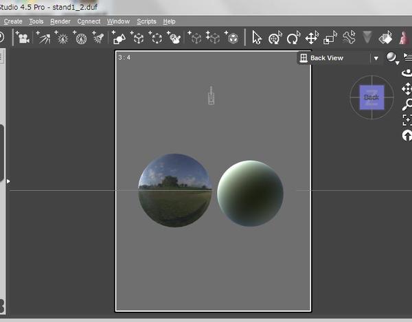

but,, a few weeks ago,, I want to try IBL then study and did some test.
Now I believe,, the IBLmap and effect are different direction.
these pic show it clear.
sphere is sopt light rendered prmitive sphere with ds default shader,
left sphere is UE2 light. applied KHpark.dsa.
just change scale.
the green part of rendered primitive,,should be caused by underground lawn glass of image map.
but the direction is different. it show the axis of rotation is titled.
daz can not correct this wrong rotation?
and how to fit your gackground image and effect of UE2 ?
simply rotate parented sphere, and adjust it?

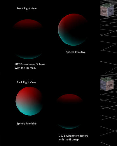

    Yes, clearly the sphere is just a visual reference but it's no use if it isn't accurate. With a little more testing, though, it's starting seem like the problem isn't that the EnvironmentSphere or UE2 is tilted but rather than the mapping for UE2 (the lighting, not the reference) is distorted. See the attachment image.
    The image displays the UE2 Environment sphere and a white sphere primitive lit by UE2 only. UE2 is set to Occlusion with soft shadows (I probably should've used Ambient but the results match these anyway) and the image used for the lighting has an even red color (horizontal gradient) on the top pole and an even green gradient on the bottom pole - as displayed by the Environment sphere. What we should be getting is an even red light distributed straight from the top, and an even green light distributed from the bottom. Clearly this isn't the case.
    edit to add: I'm using DS3 here but the results are the same with DS4.5

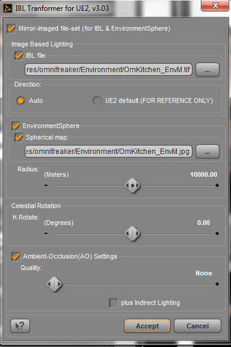

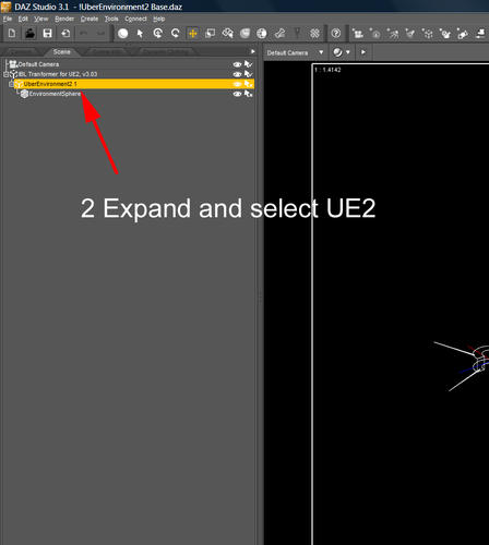

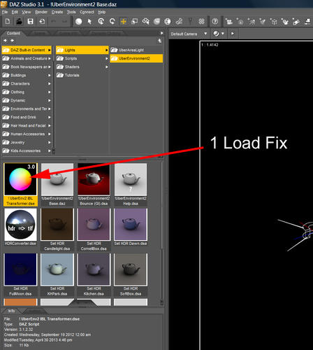

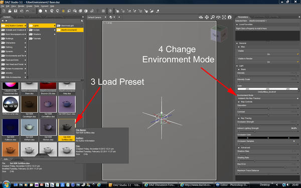

    Ok, I downloaded the script, but when I run it, I get a dialog box. Why doesn't it just correct the rotation problem right away? Why would I need to select options?
    What are the options I need to fix this rotation problem with the IBL?
    384 x 577 - 77K
  • SzarkSzark Posts: 10,634
    Just hit Accept and load a preset from the UE2 library or set up the HDRI map and set the settings manually.
