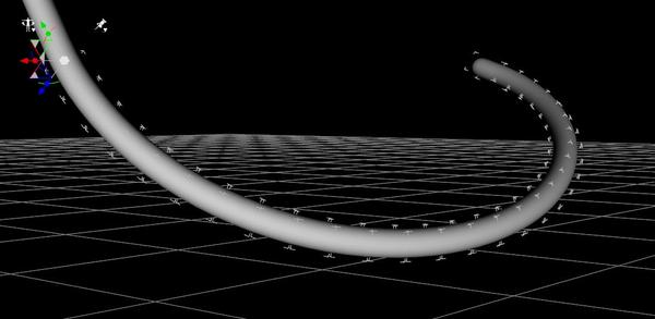

    One thing that you can do to get smoother shapes with ropes is to select an individual segment where you want the bend to start via the scene tab. What you can do then is right-click and choose 'Select Children' which will select all subsequent parts of the object, whether it's a whip, a tail or a rope. Bend them and twist them via the parameters tab (You should notice a number beside the 'Bend' sliders indicating how many objects are selected) and every link in the chain will inherit the same bends, giving you very smooth movements.
    You'll want to tweak it a bit for maximum effect, but it will greatly speed things up when you want a curve.

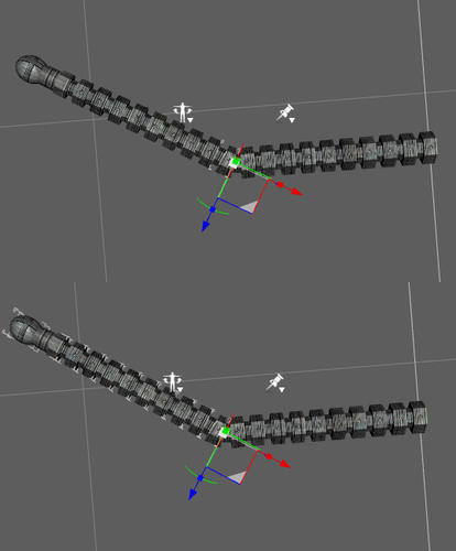

    I have tried this, but don't see what you mean. When you bend a single bone of a rope, cable etc. all the children move anyway (they remain in a straight line). Selecting all the bone's children before you make the bend has exactly the same effect, ie all the children still move while remaining in a straight line.
    So it makes no difference whether you "select children".

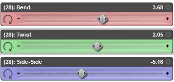

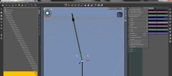

    It works if the properties are consolidated, which I believe Daz Studio does as the default setting. Click the context-sensitive menu in the parameters tab and ensure there is a tick by it.
    If it works, you'll see a number beside the shared properties like Bend, Twist etc. The number indicates how many of the selected objects share that property. Pics below as an example.
    Nope. I have "properties consolidated" checked. Still not working (see screenshot)

  • Richard HaseltineRichard Haseltine Posts: 111,677
    You need to uncheck it, not to check it.
  • SertorialSertorial Posts: 962
    Herald of fire and jetsmart said it should be checked.
    But it doesn't work if I un-check it either.
    AHA! I have found it!
    You have to un-check "Display separate items"
    And jetsmart and Herald were right, that "consolidate properties" must be checked
    Sorry, yes - I forgot which of the two it was to uncheck, I just remembered they mustn't both be checked.
