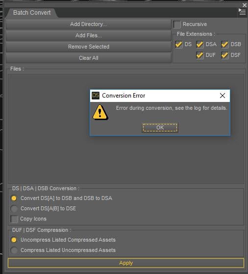

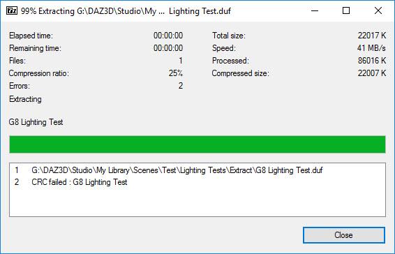

    Unfortunately, expanding the file didn't work with either Batch Convert or 7Zip.
    Here's what the Log File said:
    2017-08-08 19:43:21.232 Compiled C:/Users/Janice/AppData/Roaming/DAZ 3D/Studio4/temp/shaders/brickyard/{067ef1f1-8ca5-4c01-a38b-4bec6dce33d9}/shader_Surface.sdl...
    2017-08-08 19:45:16.805 Error converting the following files:
    G:/DAZ3D/Studio/My Library/Scenes/Test/Lighting Tests/G8 Lighting Test.duf
    506 x 559 - 59K
    566 x 364 - 62K
    Post edited by dracorn on
  • Sorry, I think the file is bad - though it may not be quite the same issue as in the past I have been able to partially extract. All I can suggest is, as above, sending it in so the developers can perhaps figure the issue out (or perhaps provide an option to save uncompressed).
