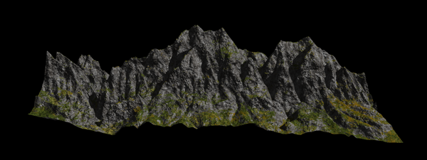

  • cryan_1832017cryan_1832017 Posts: 0
    Here are the Boulder Co Flatirons modeled using this technique
    1280 x 480 - 471K
    1280 x 480 - 471K
