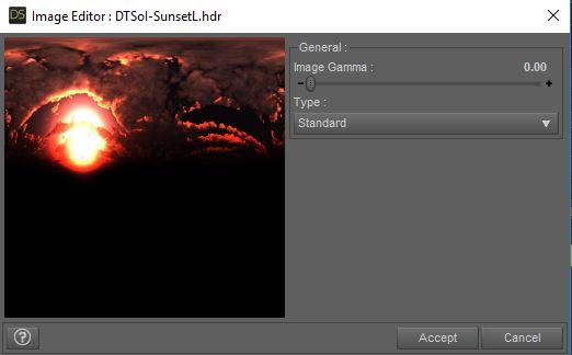

Hi. I found some free HDRI to use as environment maps (dome) but some of them need gamma 1. They look washed out because Daz 3D uses gamma 2.2 as default. Is there an easy way of fixing this problem or should I just stick with HDRIs that have gamma 2.2 already?
  • FishtalesFishtales Posts: 6,232
    I try to remember to set all images used in DAZ Studio to 0.00 as DAZ Studio sets the images to 2.2, if you have it set to that, which adds the Gamma to the Gamma already set in the image which will wash the image out.
  • Click the micro-thumbnail next to the colour bar for the environment map (the one you click to get to Browse.. when you want to load a new map) and select Image Editor - you cans et teh gamma value there.
  • dawnbladedawnblade Posts: 1,723
    I didn't know this! I've been using the HDRs that I bought in the store without changing them, and I just checked and this one was set to 1. So, set Gamma to zero for the image in the Image Editor, and leave Gamma at 2.20 in tonemapping as is? Is there any way that DS could force the image to zero automatically?

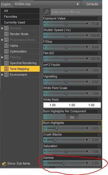

    Seems like unless you are using Sun & Sky that the gamma should be set to what the gamma is in the HRDI
    Post edited by nonesuch00 on
    My understanding is that Studio adds whatever Gamma is set under Tone Mapping on top of whatever Gamma is set in the image being used. Setting the Gamma to match the image Gamma then means that a Gamma of 1.00 in the image becomes 2.00 in the render and a Gamma of 2.2 in the image becomes 4.4 etc.. Perhaps I'm not understanding how Gamma is implemented in Studio but changing the Gamma to 0.00, when I remember, is how I do it.
  • As I understand the process the image gamma is used to linearise it, to make it gamma 1, then that is used to render and the Render Settings gamma is then applied to the output.
    I have had a look at some of my rendered images in IrfanView and it is showing the Gamma as 1.00 so it looks like Studio sets Gamma at 1.00 when the render is saved.
