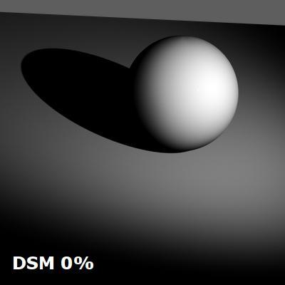

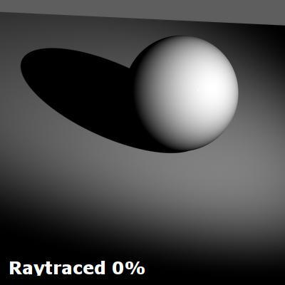

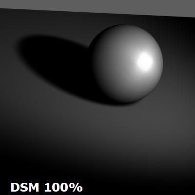

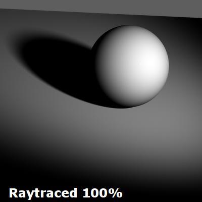

    Shadow softness works with both Deep Shadowmaps AND Raytraced shadows
    All images...
    Scene: Plane, sphere, single spotlight.
    Studio 4.5.1.56
    Image 1: Deep Shadowmap, Softness 0%
    Image 2: DSM, Softness 100%
    Image 3: Raytraced, Softness 0%
    Image 4: Raytraced, Softness 100%
    400 x 400 - 10K
    400 x 400 - 10K
    400 x 400 - 8K
    400 x 400 - 9K

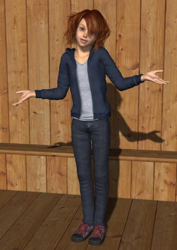

    Has it always? I was sure I'd tried softness with mapped shadows in the past and it had failed to work, but I haven't even tried recently. Well, to partially answer my own question it works in the final version of DS 3
    ...I've used it a lot with DSMs as Raytracing on my old system was a sure trip to a render crash.
    600 x 848 - 303K

    ..in the pic above I used 2% softness.

    ..that's what I did in the pic I posted. Used one full intensity "main light" with shadow" two low intensity rim lights one low intensity backlight one low intensity ambient from below and one low intensity ambient fill from above.
