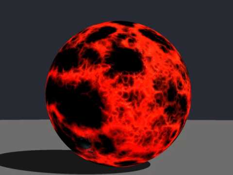

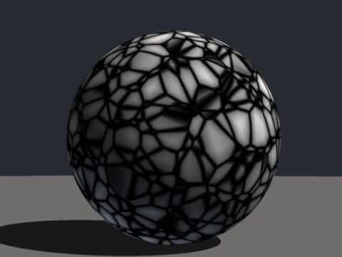

    Mosk the Scribe, if you have Carrara 8.5 you could try taking advantage of the 'Multi-layer' and 'Multi-layer elements' options in the Shader room.
    In the Color channel, I chose 'Multi-layer' from the chooser Operators > Multi-layer
    Using the 'plus' sign you then add a 'Multi-layer elements', which have their own Shaders. For my Shaders I chose Cellular and dialed in 5 very different settings.
    I then animated the Opacity slider which you will see when you select 'Multi-layer elements' in the Shader Tree.
    I'm pretty new to the concept of being able to stack up textures in 8.5, but the method popped into my mind and thought it worthy of a test. You can use texture maps or even switch between procedurals. Strangely, the bottom most layer seems to be the 'top' layer which seems backwards to me, but like said I'm just experimenting.
