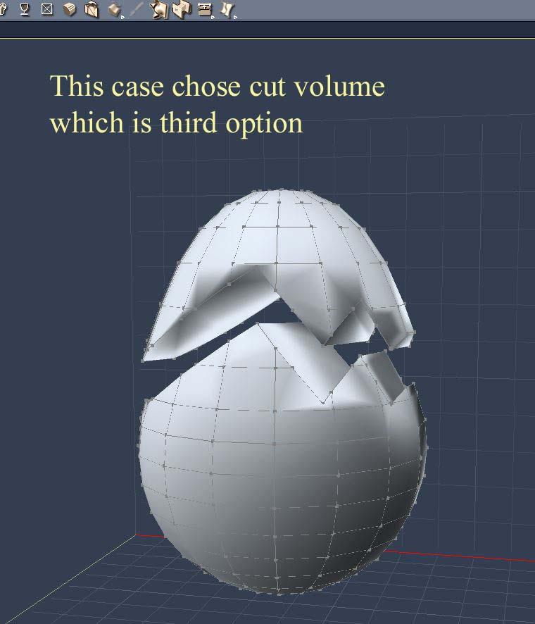

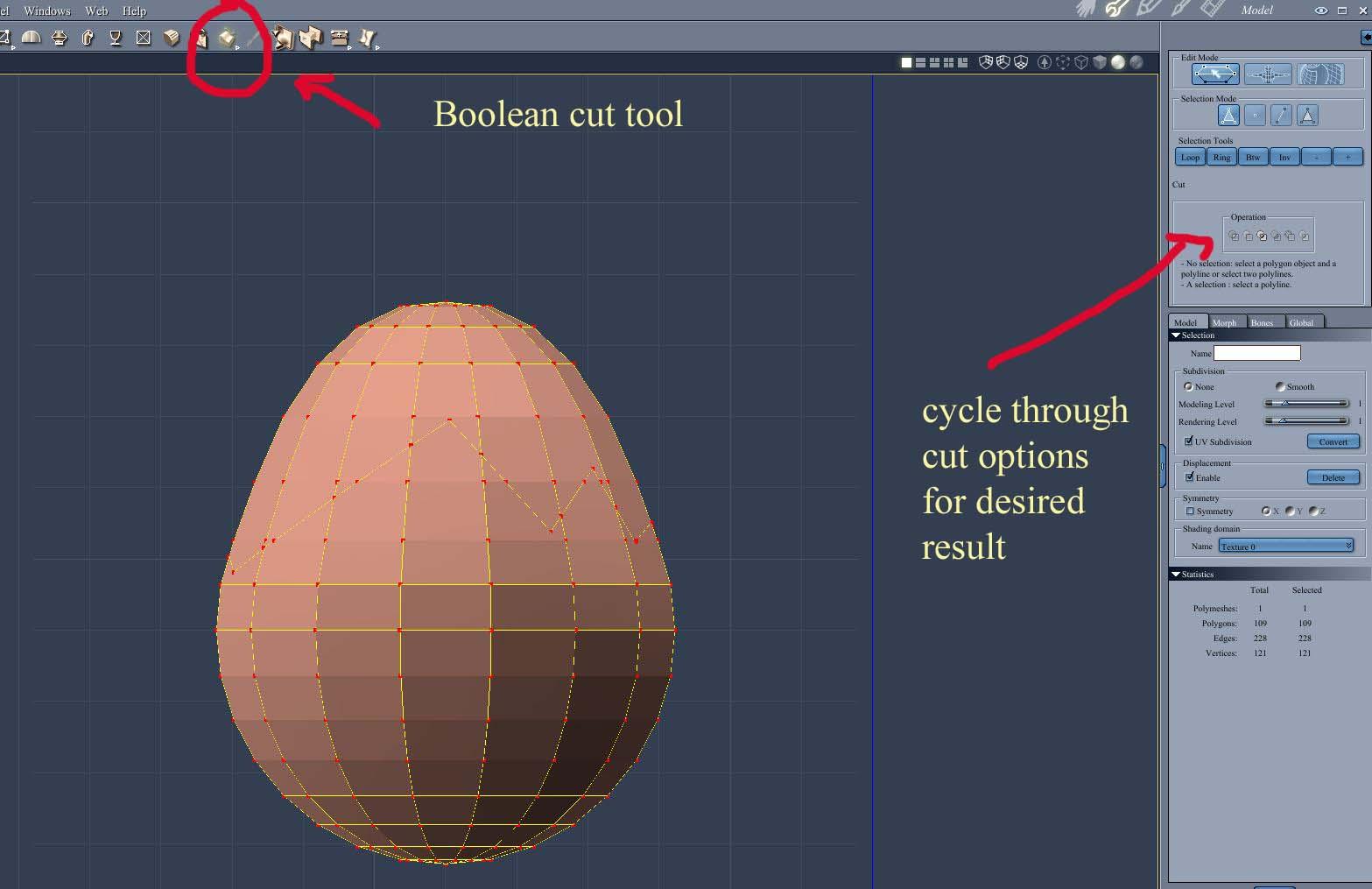

    Make sure your polyline for cutting is completely behind the egg.  Sometimes a point may get caught in the object being cut instead of behind it.  There are several boolean options listed in righthand properties panel. Use plus key to cycle through, or click on icons in righthand panel.
    1567 x 1015 - 117K
    1296 x 772 - 79K
    760 x 886 - 74K

    Thanks for the clear explanation and the screenshots.  That was indeed my problem - polyline was getting distorted in 3d when i clicked over the egg area (didn't realize that in Front view).  Moved egg and drew in one plane as you showed, and working correctly now.  Thanks!
