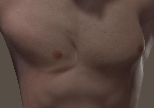

Just bought PP2012 and V5 and M5.
Installer DSON importer.
M5 and V5 both have problems in the left breast.
On V5 the right breast is pulled over to the left.
On M5 the right breast is pulled to the centre and in so there is a discontinuty between it and the breast bone (chest part)
Any help please?
525 x 367 - 10K

    Is this using the character files, or loading a plain Genesis and setting the morphs? I did the latter and didn't get distortion. Have you tried using Edit>Restore>Figure if you are using the Michael 5 or Victoria 5 characters? What do you get if you load a plain Genesis? My suspicion would be that you have a morph set or character installed that is set to be non-zero by default and that's conflicting with the shapes of the figures, or it may simply be that the left pectoral bone is posed away from its zero position..

    This is right "out of hte box" so to speak.
    I do have (lots of) old character files etc, but none based on Genesis.
    The Genesis base figure seems to be the source of the problem.
    I have basically just loaded these files.
    595 x 439 - 16K

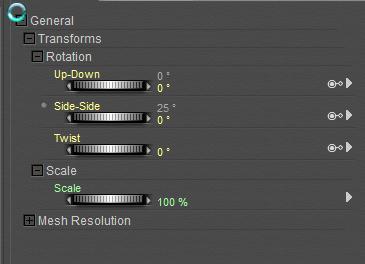

    Have you tried selecting the right pectoral bone and making sure its rotations are all zero?
  • edited March 2013
    I had not but I have now and all are 0.
    365 x 264 - 11K

    No they aren't - look at Side-Side, it's set to 25 (remotely, via ERC, rather than locally). Check the settings on the root (the Figure) under Upper Body Breast - there are several "morphs" which could be doing that.
