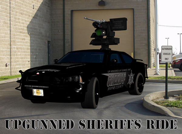

Okay I am having no luck at puling this off! The Background is a pic I took myself. I have a Shadow catchers object and a dome light and 4 other spot lights working on this..
I am having no luck with a dark shadow under the car... No luck with any definition of the car body at all.
In real life even if one has a solid black shiny car you can still make out the details!!!
Also the license plate is like glowing screamingly loud

    What are you rendering in?
    Kill the Ambient on the plates...
    What kind of shadow?
    Any custom/special shader for the carpaint?
    Is there an reflection set for the paint?

    Yes car body is a texture map for color, some shine and highlight. Reflection set at like 6 percent. I am not sure what ambient on the plates is or how to shut it off? All shadows have a soft shadow to some degree!
    Rendering in Carrara 8 pro
    What's the "to some degree" for soft shadows? Are you using soft shadows for the light dome lights? The point of a light dome is to provide light from multiple directions, simulating Skylight or Indirect Light. They should create their own soft shadows depending on the number of lights. Light domes and HDRIs (using Skylight) as mentioned should produce diffuse shadows. To create the darker shadows and highlights you need to use something bright such as a spotlight or distant light. If you use soft shadows, the larger the light diameter, the fuzzier and more diffuse the shadow's edges. If you couple that with a shadow setting of less than one hundred percent it could look like you have no shadows at all.
    Do you actually have anything for the reflection on your car to reflect? Backdrops don't add reflections. To turn down the "ambient" mjc1016 refers to (maybe a DAZ Studio term?) I am assuming it's the Highlight/Shininess. Speaking of Highlight and Shininess, try turning the Highlight up (brightening) using a 1-100 slider and the Shininess down ("spreads" the Highlight effect) using the 1-100 slider.
    It may be best to simplify your light set up first. Hide or turn off all lights except the main light (sunlight) which is shining on your car. Might work best to make this a distant light. Look at the shadows in your photo to see how they spread. Turn on Soft shadows and try increasing the light diameter from the default .08 ft to 25' Increase in increments of 25' until you get the desired spread. The shadow will appear very dark. Now is the time to try your light dome. If it washes out the shadows adjust the brightness of the lights down.
    I play in Carrara rarely, so I tend to stick with Studio terms (haven't actually done anything in over a year)...
    Another thing...with black car paint, in general, it's not usually completely black. In RGB terms, it could be something like 1 1 1 up to about 7 7 7 (extremely dark grey) or even something like 0 0 3 (very, very dark blue) as a base with tiny metallic particles in it or particles of a lighter colored pigment. And some type of glossy top coat. All arranged in layers...sometimes with differing refractive and reflective properties for the layers.
    It's those particles and differences, especially along edges, that keep the details from getting lost.
    So a shader for it should be a little more complex than just a texture map.
    Adding something that can actually be reflected will help some. Almost every renderer around needs either actual geometry/environment or some kind of 'fake' (environment map)...something to reflect...to be surrounding the item you want to be reflective.

    I assume you put the image into the backdrop of the scene in Carrara, or maybe composited it externally in **shop or something. You can ALSO put it in the background of the scene in Carrara, which is used for reflections. For more accurate reflections, the ideal would be a spherical image in the background slot. (keeping your existing image in the backdrop slot.)
    For that spherical image, you have a few options, such as Hugin to stitch multiple photos into a panorama, or use a single photo of a mirrored ball, and use a program such as HDRShop (The free version 1, not version 2.) or Flexify to convert that to a latitude/longitude map. Ideally you should take that photo or pano sequence from the position of the car, as that will give the best reflections. (Assuming you still have access to the location.) It may sound like an HDRI technique, and partly it is, but if you are doing the lighting manually, there is no need for multiple exposures or real HDR.
    The mirrored ball is a trick used by movie studios to capture an environment map for mixing CGI with live action. This will work: http://www.mcmaster.com/#alloy-steel-balls/=lva6yk
    or something like this: http://www.ebay.com/itm/STAINLESS-STEEL-MIRROR-POLISHED-HOLLOW-SPHERE-1-PC-6-DIA-15299-66-/400435684438?pt=LH_DefaultDomain_0&hash=item5d3bd3a456
    The 2" version is easy to carry with your camera equipment, and I made a small holder to fit mine on a tripod. The larger one will give you more detail.
    Also, for your shadow, make sure the ground is set with the shadow catcher shader, and make sure you have a good strong light source (wherever the sun is supposed to be) and the other fill lights are toned down. If the sun is at 100%, and you have 5 other fill lights, they should be set less than 5% each, at least to start with. (Adjust as needed from there.) That should help with the bright license plate. With that black color, and nothing to reflect, it would be easy to over-do the lighting. Adding a simple grey ball to the scene will help you adjust the lights. The sun should have soft shadow, but not too soft.
    You might also bring that black up a little. No paint I've seen is truly 0% black. Try 2% or 4% and see if that helps. You don't have to change the texture. Just use the "Add" operator in your shader to add the 2% to the texture. (Multiply can also be used to adjust overall brightness) And once you add the background, make sure there is some reflection, maybe in the 10% to 20% range.

    Also try backing off on the dome lights, and focus more on the lights providing the directional shadows you're looking for. Once you get your shadows happy, perhaps you can bring you dome lights up a touch again.
    If you don't want to mess with a spherical render for reflections, and you planned ahead and got a couple different angles when you snapped the original photo, you could add a plane to the scene, apply one of your other images to it and place it behind the camera. It will need to be large enough that the whole plane is reflected in the car. You could pre-blur the photo so you get blurry reflections as well. Might help to put the phot in the glow channel and adjust intensity as needed.
