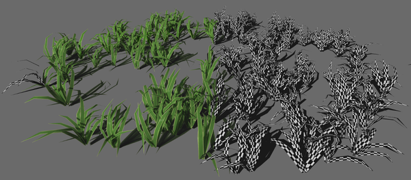

    Just to let you know chaps
    I did have success. The Blender route I was looking at works very well, in fact it did it so silently I had to take a double check to make sure all the objects had the uv map transferred to them. Some of you will know that I have been playing with plants, custom for Bryce really, I had a grass generator for some time,it does not use any mapping, it is very old, I wanted to improve on its output "uv maps" so that I could use a procedural parametric material or an image.
    Steve athome posted a link above "thanks" to the Blender manual page explaining how it is done.
    Here is a test in Bryce
    1050 x 460 - 521K
  • RoygeeRoygee Posts: 2,247
    Aah - the penny drops!
    Nicely done:)
