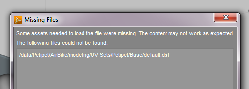

I'm getting the error shown, when I use a material preset on the airbike but then the material seems to apply correctly. Are others getting this, and does anyone know what could be causing it?

    This is the data tree:
    \---Petipet
    \---AirBike
    \---DZ4
    | Airbike.dsf
    +---Morphs
    | \---Petipet
    | \---Base
    | Clock.dsf
    | Engines Spin.dsf
    | Fire.dsf
    | landing gear.dsf
    | Light Spin.dsf
    | Lights Spin.dsf
    | Needle1 Spin.dsf
    | Needle2 Spin.dsf
    | Needle3 Spin.dsf
    | Needle4 Spin.dsf
    | Needle5 Spin.dsf
    | Trunk Open{2F}Close.dsf
    \---UV Sets
    \---Petipet
    \---Base
    \---Base
    default.dsf
    I don't have a \modeling subfolder in my tree structure. It looks like the path should reed \UV Sets\Petipet\... ?
    Post edited by Joe.Cotter on
  • Richard HaseltineRichard Haseltine Posts: 111,996
    Have you checked for an updated version? If so, please make a bug report - it looks as if the files have the wrong path (you can uncompress them and edit them as a fix, though the installers should be updated by DAZ).
  • Joe.CotterJoe.Cotter Posts: 3,362
    It is the same version number as the current (1.0) I did submit a bug report through customer service but that takes time and I was wondering if anyone else was running into the problem.
