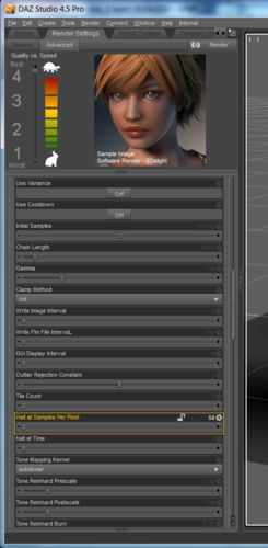

    With the way it is integrated you should be able to do it just like you would a 3delight render. Just make sure you set a reasonable halt condition. Although, to look good, LuxRenders take a long time.

  • SphericLabsSphericLabs Posts: 598
    mjc1016 said:
    The problem is that in the 3Delight render, you can go direct to avi...which isn't something Lux can currently do...it HAS to be a sequence of images in DS. And the halt condition can be finicky....although I did see some mentions of work/improvements on it in some of the more recent builds (there's several animation threads on the Lux forums, that I haven't read in a while).
    I didn't mean to sound like it was impossible...just that it won't be very easy and probably would require actually monitoring the render process. Not quite as automatic as the 3DL option.
    Image Sequence does work, but Avi does seem to be broken. Looks like I am not calling something to combine all the images into the avi. I will fix it.
    mjc1016 said:
    Image sequence working...that's great.
    What are the halt condition settings? That's probably the biggest hurdle with using Lux for animation...getting good results quickly and getting it to move on to the next frame. It's got fantastic native queing support.
    The way Luxus is setup it runs LuxConsole for each frame and then stop the process when LuxRender halts on that frame, it then moves on the the next one.
    You can set a target samples per pixel condition or you can set a max time per frame. Not great, but somewhat doable.
