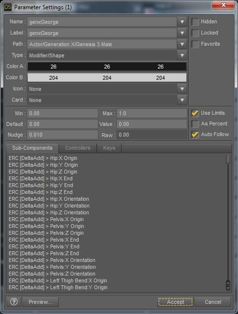

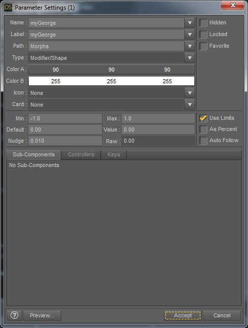

    On the off chance that this interests or might help anybody else, I'm posting my findings in this thread while trying to solve this problem. Here's an analysis of a concrete example comparing 2 morphs:
    The first is a morph for George transferred to G3F using Genx2. George's shape can be dialed in on G3F with this dial, and clothes fit to the figure conform to the new shape:
    The second is a morph created programmatically using the code referenced in the previous post. George's shape can be dialed in with this dial, too, but clothes fit to the figure do not conform to the new shape:
    The differences that I can see are:
    1. The path, which I don't believe matters.
    2. Auto follow is checked for genxGeorge, but not for myGeorge. I have tried manually setting Auto Follow, but clothes fit to the figure still did not conform to the new shape.
    3. And obviously, all of those subcomponents on genxGeorge.
    After having a look in the Property Heirarchy, these look like they may be projection information on a bone-by-bone basis:
    I wonder if this information is part of what GenX2 calculates (and likewise Morph Loader Pro)? Or does the plugin API (and hopefully the scripting API) expose methods to add these properties based on the deltas? Unfortunately, I've got to go get some real work done now, so my investigation will have to stop here for now.
    - Greg

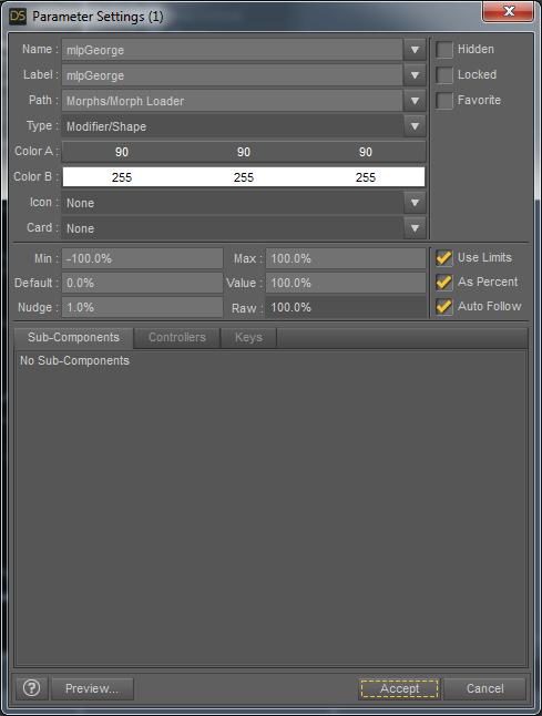

    Consider the following - George morph #3 which we'll call mlpGeorge since it was created using Morph Loader Pro. Like genxGeorge, mlpGeorge can be used to dial in George's shape on G3F, and clothes fit to the figure conform to the new shape:
    As you can see, there are no sub-components. The Parameter Settings are like myGeorge's, with the addition of Auto Follow.
    It looks like the sub-components in genxGeorge weren't the issue. I've since dialed in the morph with the Joint Editor active and it seems to confirm that the subcomponents are for adjusting the rigging to shape. The rigging adjusts as I dial in genxGeorge, but does not as I dial in mlpGeorge or myGeorge. The sub-components in genxGeorge match the parameters under the Rigging sub-heading of the Parameters Tab when bones are selected. Hurrah for learning things!
    So the problem seems to be that Auto Follow is not working on morphs created via script (at least not the way I did it). I haven't looked any further into setting Auto Follow via script, but when I set it manually from within DS on myGeorge, clothes fit to the figure do not follow the shape.
    Maybe there's something else that needs to be configured?
    Maybe it's only possible via plugins, but not via script?
    Has anybody been successful creating a morph via script and getting conforming clothes to follow the shape?
    - Greg
