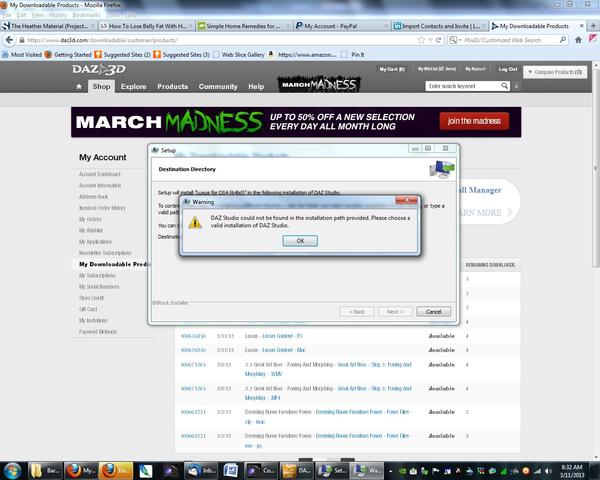

I just bought Luxus... I have Daz4.5 (the latest version) and Daz3 running on Windows 7 with a 64 bit machine. I go to install Luxus and it won't install. It says it won't let me (screenshot attached), "

    Hi there - Well I downloaded the product and then tried to install the 64 bit version. (The background you're seeing there is where I never left the download page.) One of the smaller files installed fine. The big part - I'm assuming the program itself - won't install. I double checked and it is indeed pointing to the path that I have the DAZ program in. I also tried pointing it to my content folder with no success. (hands you a chocolate internet cookie as thanks for responding)

    The file you should be trying to install is this one : 15891_DS4_Luxus_1.0.0.2_Win64.exe
    It must go into the same folder that you have DAZ Studio installed to, and it puts in a file in the Plugins folder called Luxus.DLL. You should check in Help > About Installed Plugins, and you should see it in there in alphabetical order.
    . The big part - I’m assuming the program itself - won’t install. I double checked and it is indeed pointing to the path that I have the DAZ program in.
    Do you get an error message when you try to intall it, if not, it has probably installed OK, follow the advice above. If you can see it in Installed Plugins, then it is all OK.

    As I said before I checked: and it's going to my DAZ program folder. Or you'd think it was. I didn't exactly change any installation settings when I installed 4.5 except for where the content folder was, and it looks like all is there when I manually go to the folder. When I try to install it, it stops and says that it can't find a valid installation of DAZ3d (as shown with my screenshot). So I'm not even getting to install it (which I find utterly stupid that the stupid thing would even look for DAZ3d; just let me install it already. I paid for it. It's legal. DAZ3D was free - c'mon.)

    Okay, figured it out. It's trying to go to Program Files when it NEEDS to point to Program Files (x86). Thanks for trying! :-)

    Can you post a screen shot of the 'previous' screen...the one showing behind the error message. It is sounding like the installer is going one level too deep or maybe not deep enough.

    If your DAZ install is in (x86) you have the 32bit version installed and you need the 32bit plugin.
    Back when you installed Studio you will have had installers for the 64bit and 32bit versions. You may may have installed only one.
