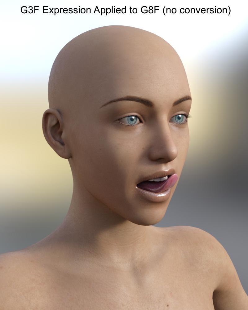

    Because "pics or it didn't happen": attached a quick render of G3F and G8F for comparison.
    Edit3:
    Because all good things are three. :)

    In the few examples I've tried, Zev0's G3 to G8 pose converter also works on expressions and hand poses. Again,I've converted several packs, but only looked a few. In those that I've tried on character, my general impression is that they seem more natural on G8. Some of the "bite lip" ones don't look quite right, but i haven't tried G3 and G8 side by side
    Here are some examples.

    Here is a comparison of a G3F expression on G3F, the same expression on G8F without conversion, and the converted expression on G8F. The improvement due to the conversion is very evident. The converted expression looks much more like the original.
