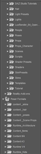

    Can you open your Content Directory Manager, expand the "DAZ Studio Formats" and :Poser formats" sections, and post a screenshot?
  • KatteyKattey Posts: 2,899
    edited March 2013
    Sure, here they are
    Poser folders are exactly the way they were in DS 3. Actually, I just mapped them again, as DS 3 is still installed and running (only it messes up with some of my DS3 scenes just like DS4 does)

    In DS4, go to Edit > Preferences > Content Library > Content Directory Manager;
    In DS3, go to Edit > Preferences > Directories > Content Directory Manager;
    Expand both DS and Poser formats and post screenshots

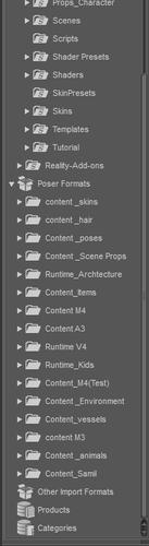

    edited March 2013
    Here
    DS 4, then two screenshots from DS3
    693 x 626 - 64K
    686 x 611 - 88K
    346 x 471 - 65K
    Post edited by Kattey on
  • JaderailJaderail Posts: 0
    edited March 2013
    Um... Your DS folders must be mapped as BOTH DS and Poser content Folders, And your Top DS folder needs to be your Top Poser format Folder as well.
    EDIT: And your DS Paths do not even Match the Mapped paths.
    Post edited by Jaderail on
  • fixmypcmikefixmypcmike Posts: 19,718
    You should have the 3 folders listed under DS formats under Poser formats as well, or the textures won't be found. Can you do a screenshot of the DS3 version?
    Why should I map DS folder as a Poser folder if it is a DS folder?
    Yes, two last screenshots
    The top Poser folder doesn't have to match the top DS folder, but the top DS folder is where the Data is written, so the DS3 one needs to be listed in DS4. The first 2 folders in DS3 are nested, which could be messing things up.

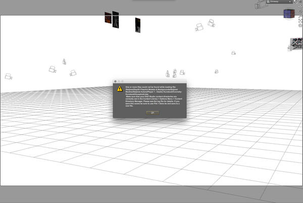

    Can you check one of the error messages and search for the exact file name it's looking for?
    Sure.
    It says: "Unable to find files"
    One or more files could not be found while loading file
    Make sure that your DAZ Studio content directories are correctly set in the Content Library > Options Menu > Content Directory Manager. Please see log file for details. If you safe this scene be sure to use File > Save As and save to a new file."
    Log file lists all missing data which is too long of a list to quote.
    This situation is weird because DS3 was set and worked correctly with this same scene before DS4 was installed.
    I can merge data folders from DS2, DS3 and DS4 but a) I don't know if it would solve a problem. b) I'd prefer to keep them separately because I still use DS3 sometimes.
    Just select one of the files listed in the log and search your hard drive for that file, so we can find out where it is (if it exists somewhere DS isn't looking).
    OK, I did the search and found my old DS2 data folders. After I mapped them all M3 scenes seems to load in DS4.5
