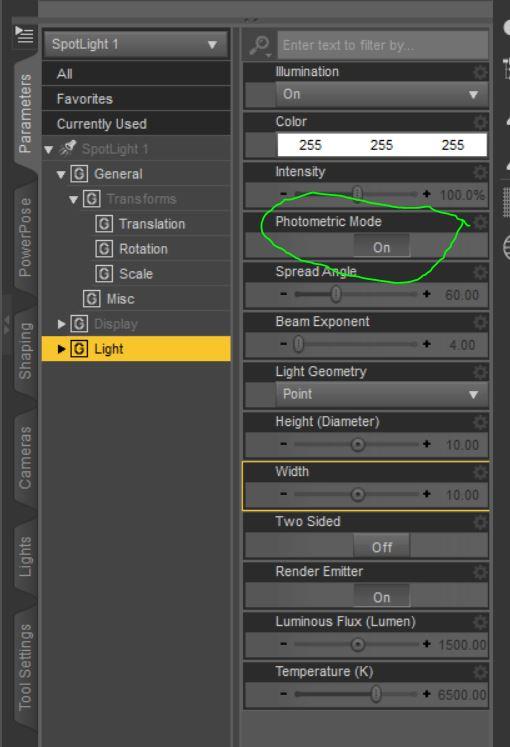

    I often use the spotlight in IRay but the point light should work too. You need to make sure Photometric is switched on and then play with the luminosity (generally I need to increase the Lumen default x10 or x100).
    510 x 747 - 54K
