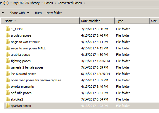

I see this
Should there be a local user heading?
And navigating to the files that work, gives me this....
Which shows the conversion happened, but Daz doesn't see the files- and I checked they are all that DSON and png formats.
SOME of those folders show up and others don't.
Any ideas?
