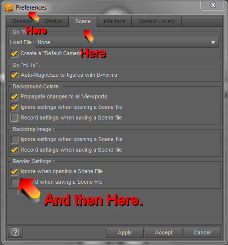

    By the way, when I change a render setting (like Max ray trace depth), does it change it for only that scene? I kind of want to optimize my settings and then leave them like that for eveyrting

    that's what I thought, but each time I load a scene I have made before it seems to change the render settings (as though they got saved with the scene)
  • JaderailJaderail Posts: 0
    edited March 2013
    Here this will Help...
    455 x 488 - 50K

  • SertorialSertorial Posts: 962
    Great! Thanks!
