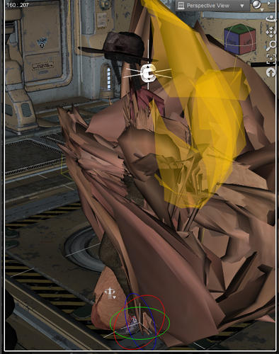

  • IppotamusIppotamus Posts: 1,580
    edited August 2012
    I'm in a similar boat.
    I waited until 4.5 was actually released to avoid this exact situation.
    Lost a 2 days "work" to this mess and I doubt I'll be able to save the scene.
    But after applying the script to Fuji hair for Genesis... it seems to be working, saving and loading.
    Not a fun couple of days that's for sure.

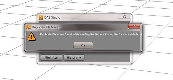

  • Shadowl1980Shadowl1980 Posts: 60
    edited September 2012
    I am having the same issue except mine is with the genesis character itself is this the message you are getting. I've uninstalled 4.5 and went back to 4.0 and I do not get that message anymore. something is seriosly wrong with this program I don't think they tested it before releasing it.

  • Richard HaseltineRichard Haseltine Posts: 111,935
    This isn't a general issue, so I suspect it's down to one of the following:
    old content did not uninstall correctly, leaving both old and new versions of some file - did you load the .duf or .dsf version of Genesis?
    multiple copies of the Genesis data foldrs in different, mapped, content directories
    default scene contains content that hasn't bee, but needs to be, updated.
  • vwranglervwrangler Posts: 5,056
    A question: do you have GenX? Because every morph file created by GenX loads with Genesis every single time, if one of those files has an issue, then Genesis itself has the issue. (This only applies if you used GenX to create shaping morphs in the Shaping tab, not for any presets, which don't load with Genesis but have to be invoked.)
    If you click OK on that message, Studio will load Genesis. At that point, you can look at the troubleshooting log file to see which file produces the message. You can either scroll to the end and go backward until you see the duplicate IDs message, or try search and replace; I find scrolling to the end easier because the log file can be fairly large.
    Files produced by the recent update to GenX don't have that problem, and not all of the files produced by the old version have that problem. In my case, I removed the offending file, redid the morph and everything was fine.
    If you don't have GenX or haven't used it in this way, then hopefully someone else can help you with the issue.
