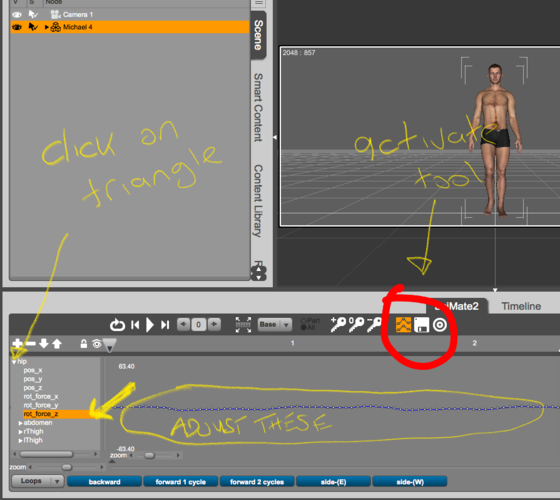

  • ps1borgps1borg Posts: 12,776
    you use an aniMate tool:
    895 x 799 - 150K
  • Coon RaCoon Ra Posts: 200
    edited March 2013
    aniMate2 -> put a block on animate2 track for genesis figure -> click the block -> go to keyframe mode -> open graph editor when in keyframe mode -> open lThigh or rThight branch (bottomleft window of animate2 panel) -> zoom the graph and move the whole bunch of "root_force_z" points up or down until satisfied with thigh angle. Same way you may fix genesis feet -> expand same tree to lFoot or rFoot and move "root_force_x" points up or down.
    Anyway, true Genesis aniblocks would be more preferable than bullshitting with gen4 movement data. If DAZ created DS4 for Genesis why did they forget updating the animations?
    PS: You may edit splines activating it in Tool Settings with Active Tool: aniMate2 after checking corresponding checkbox. Here's couple links to follow: http://www.youtube.com/watch?v=rJ5iDoNOcGg and http://www.gofigure3d.com/site/index.php?option=com_content&view=article&id=92&Itemid=86

  • freecomerfreecomer Posts: 0
    Thank you very much - just what I needed - I am going to try this right away.
    Thank you.
    That's very helpful.
    It's true what they say about pictures
