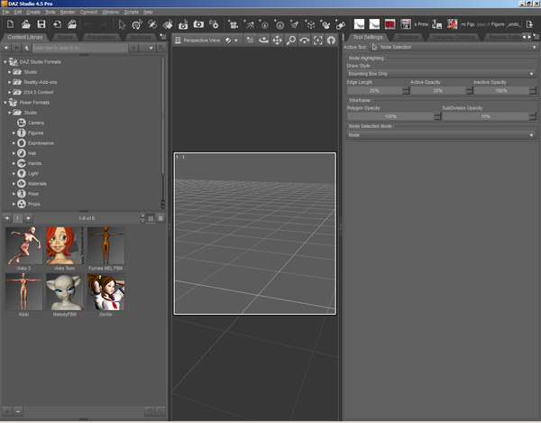

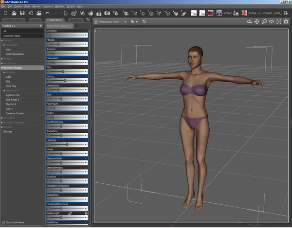

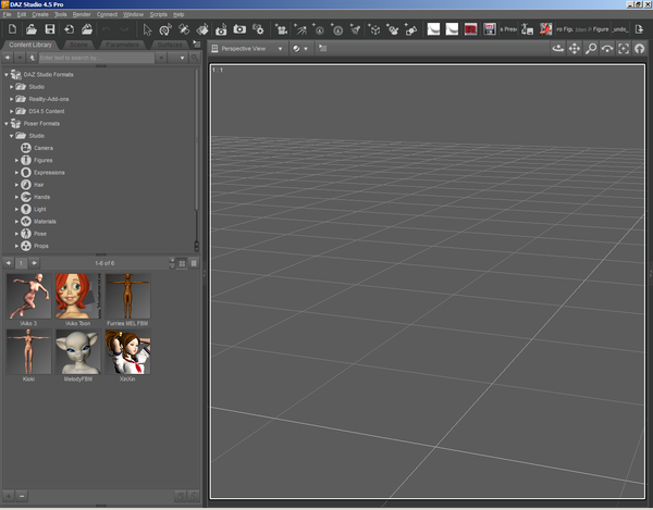

    Ok, so between DS3 and DS45 I know how you feel. Look on the bright side that we are not still on DS4 cause it was very slow to move around in the scene and UI compared to DS45.
    For a nice guide to DS45 and the basics, see the FAQ list here - http://www.daz3d.com/forums/discussion/17/
    Compared to DS3 and why you would want to upgrade, I will offer a few reasons.
    1. It renders MUCH faster then DS3. Also, DS3 will no recieve any 3Delight updates since DS45 is the current version. So all improvements done to 3Delight, DAZ will add to DS45 and not DS3.
    2. There is this wonderful little tool called the "Smoothing Modifier". Its intended for use with clothing on figures but can be used with anything. I often use it for clothes on A3 along with the "Transfer Active Morphs" option for fitted clothes. The Smoothing Modifier also works on figures. We both know how unrealistic A3's joints can look when bent, well this can really help smooth her out.
    3. Dynamic cloth works for the 64bit Windows version plus the Mac version.
    As for the UI and the way it works and where they hid things in menues, it can take a little adjustment. Again, I know how you feel. Seen below in my screen shots is how I have my DS45 set to. Also you will see a few with V4 in them. I posted those there so you can see where her morphs are and her expressions. Btw, her expressions are great. The Girl 4 brings in some really nice expressiosn. This is simular to how they set up the character shapes in Genesis. One of the screen shots shows the Tool Tab. The reason I did is that DAZ has moved a lot of the Tool Options tot he Tool Tab. Some of the options there are universal, some are not. Just depends on the tool you have selected at the time.
    As for Mac files in your download, there is no way to filter that out anymore. You can use the Download Manager to retrieve all your files if you wish and even install them if you so desire.
