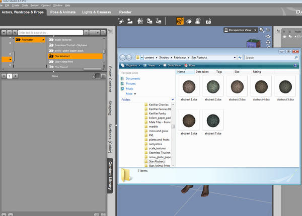

Okay so I have a bunch of shaders that I made up, and they are set up as .dsa files, they used to show up in my library correctly but since I upgraded they no longer do. I can see the files when I browse to them in my library, but not when I try and see them through Daz Studio 4.5, I can add them in if I go into the surfaces> color> diffuse color and then browse to the file and it will load correctly.
Why are they not showing up in my library area correctly?

  • SassanikSassanik Posts: 340
    Daz studio > my library > content > shaders > fabricator > star abstract
    Should I move it to my runtime folder?

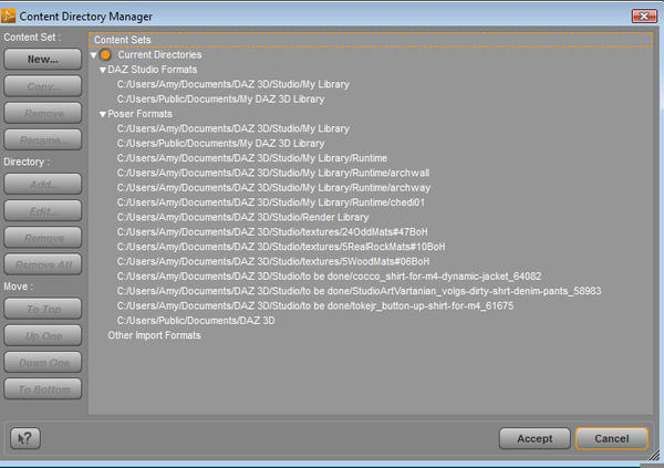

  • fixmypcmikefixmypcmike Posts: 19,719
    Having a Content folder under My Library is a problem, but it wouldn't cause the presets not to display (although it might cause them not to work). Can you go to Edit > Preferences > Content Library > Content Directory Manager, expand the DS-formats and Poser-formats sections, and post a screenshot?
    This what you are asking for?
    720 x 507 - 101K
    There are some problems with nested content folders, which might be causing problems, although I wouldn't expect them to make the .dsa files not show up.
    The Content folder under My Library is a mistake; what's under that Content should be moved up a level to be directly under My Library.
    In Poser formats, you should not have the subfolders of My Library listed; if you have Runtime under Runtime, you need to move all those Runtime folders up directly under My Library and remove the other listings. C:\Users\Public\Documents\DAZ3D also shouldn't be there -- do you have a Runtime folder there?

  • SzarkSzark Posts: 10,634
    All my DSA files have PNG Icons I see you have none there, I wonder if that is the problem, though I thought Daz Studio would show a plain default icon instead. Do you have other DSA files that you can test with by putting another DSA with PNG icon in the smae folder and see if that shows up.
    DS4.5.1.56 will show DSA files without the need for any Legacy needs. :)
  • Richard HaseltineRichard Haseltine Posts: 111,348
    Those are the PNG files, hence their having pictures and not generic DS icons. Windows iss et to hide extensions of known file types, so abstract1.png.dsa is appearing as abstract1.dsa in the browser. Which means that the files aren't saving - please try saving another, then immediately open the log file (Help>Troubleshooting>View log), scroll to the end and see if DS has thrown an error.

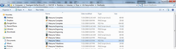

    Okay-
    So the folder set up for the skin settings is supposed to be OUTSIDE of the Runtime>Libraries>Pose idea.
    Why is it then that the poses (read skin applications) for most if not all Studio products I've purchased show in the Runtime/Libraries/Pose set up?

  • DarwinsMishapDarwinsMishap Posts: 4,087
    edited August 2013
    Okay-
    Example:
    What I am trying to do is shown in the example picture- making a skin setting so I can use and distribute it to others for Daz Studio.
    I have a .dsa (DAZ Script ACII) file, the .png file to go with- but I notice that there are .pz2's in this that go with both. I'll see if I can make a pz2 file for the script and pngs and see if they work.
